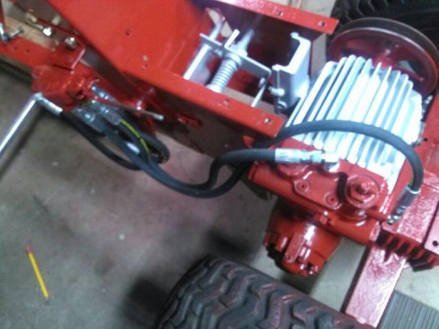

Look for a cylinder from a 70's tractor.  Try to get the valve from the same tractor.....as far as the hoses go that depends on which valve.  The Charger has a hose that starts from the back and a later model sundstrand tranny doesn't......

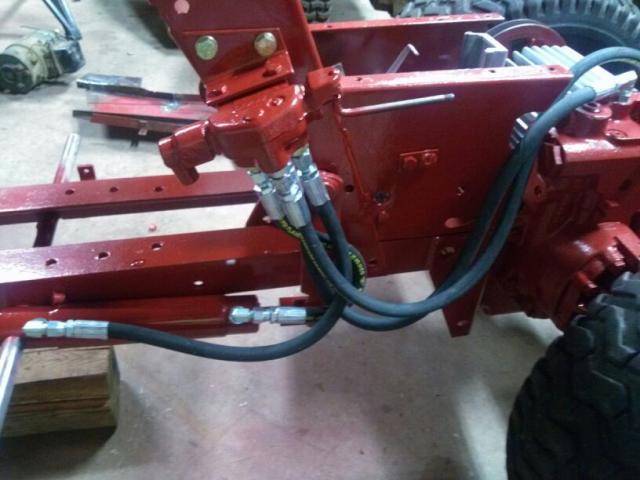

this is the tranny you have on the charger......

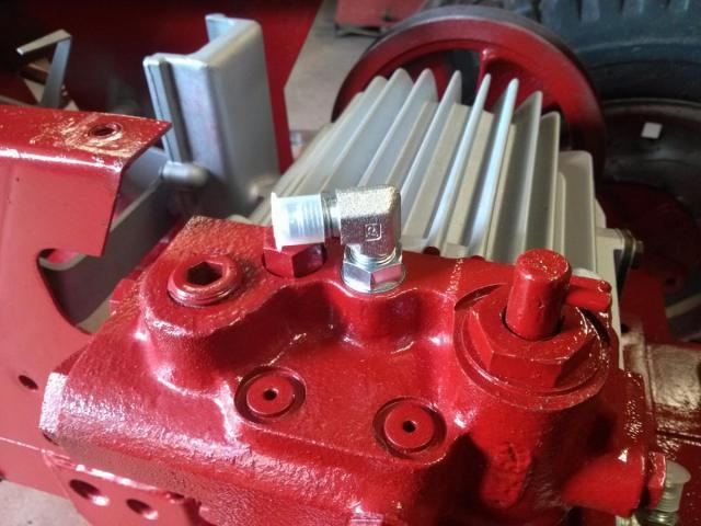

This valve is what would have been on the charger.....possibly find a set with the valve and hoses.....if you use a valve from a c series....the hoses to the cylinder are the same but the connections to the tranny at the valve are orb 5 ..... your tranny has orb 4.....first find a cylinder and valve...then we will see what hoses you need.....

Most tractor repair places will have the orb 4. Or 5 end adapters or can get them. Either straight or angled . The other end of it will be a flare end. They can then make the hose with common flare ends. I did this on a GT-14 that had a leaking 90 deg fitting. It's not stock but it worked great and it allows you to mix and match trans. with other clys. or valves.

In the 2nd post look at the first picture.....see the adapter at the top in the middle....right behind it is a valve....on yours turn it 180 degrees and try to push the tractor...if it doesn't push easily try to drive it....

Get the proper o ring thread to male pipe thread adapter for the trans. Then plump a pipe thread tee into that and go from there.
