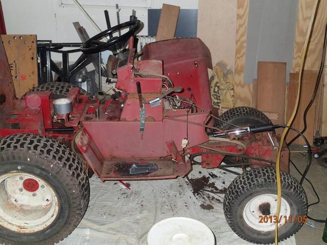

Wheel-N-It 2,976 #5 Posted November 12, 2013 Welcome to Red Square. I would jump in with some advice, but you have heard from Maynard. He is the expert. Shoot us some pics of your 161 so we can see what kind of shape it is in overall. Share this post Link to post Share on other sites
Guest jjs #6 Posted November 13, 2013 Here it is, I dont have to tell you the parts removed. I plan on replacing the bearings and see if the play goes away, are these wheel horse bearings or can I pick them up somewhere else, that is at a reasonable price. thanks 2 Share this post Link to post Share on other sites
bowtiebutler956 650 #7 Posted November 13, 2013 (edited) Here it is, I dont have to tell you the parts removed. I plan on replacing the bearings and see if the play goes away, are these wheel horse bearings or can I pick them up somewhere else, that is at a reasonable price. thanks That looks like a very solid foundation for a Great Restoration! Gotta love any powered by the big K341 Thumper!! You can buy the 3/4x 1 3/8 wheel bearings for these on for about $10 for a set of 4. I'll PM you a link. Matt Edited November 13, 2013 by bowtiebutler956 Share this post Link to post Share on other sites
W/H JUNKY 43 #8 Posted November 13, 2013 Hi jjs This is just my personal preference but I like to use brass thrust washers between the inside of the rim and the spindle and one on the outside between the rim and the cotter pin. I get them from Ace Hardware or Gilroys Hardware. Gilroys calls them brass bearing and Ace calls them Brass thrust washers. They come in different thicknesses so you can take up alittle or alot of space if needed. Also these will wear before the harder metal will. Hope this helps. Chris. Share this post Link to post Share on other sites
Wheel-N-It 2,976 #9 Posted November 13, 2013 You can pick up the wheel bearings at NAPA. I don't know the part number of the top iof my head. Just knock out the old bearings and take them to NAPA. The guys there will cross reference some for you. Share this post Link to post Share on other sites
JC 1965 1,534 #10 Posted November 13, 2013 Good looking tractor. I really like the C-160 model. If you find that your spindles need to be replaced, you can pm kelly ( he is a vender on here ) I purchased a pair of spindles from him with very little wear, and at a very good price. He is a great guy to deal with. Hope this helps !! Share this post Link to post Share on other sites
