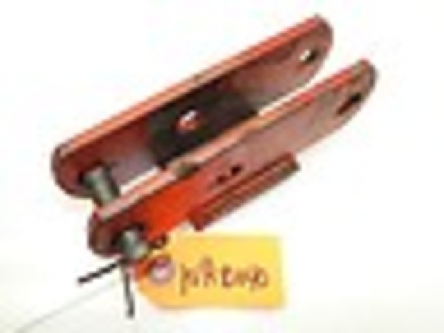

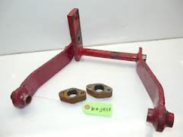

Can anyone give some measurement on the items, in the pics?

all, so i can manufacture it.

Pettson, If the smaller peice is a pivot assembly from an 18 Automatic or a "D" series three point hitch (part #102104) I have taken some measurements from one I have.
Main Side Peices:
Length 6-1/8"
Height 2"
Width 1-5/8"
Top 6"
Center to Center of holes 2-3/4" & 4-3/4"
Unitting Plate:
Length 2-1/2"
Width 2-1/16"
See also pics.  Mark
