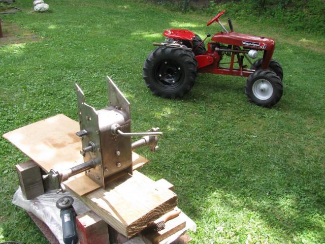

I'm not so sure this is OK to do even if I plug up the holes and stay away from seals. Just a thought I had because it would save me loads of time. But I don't want to risk anything. If anyone has other suggestions please let me know. Thanks!

A good ol' fashioned wire wheel still works pretty good.

Zane, I know you want to use that new blaster, and it would be OK if you had two empty castings...but Craig is right...wire wheel and mineral spirits is the winning combination.  :)

I wouldn't blast it fully assembled, and I certainly wouldn't blast bare cases either.
I know plenty of people on here do it, and have had no problems, but I don't believe that you be absolutely sure that you've got all that grit out afterwards.  I wire wheel and wire brush mine.
For the same reason I don't do engine parts either, although I have done a few cylinder heads.  The cylinder heads don't have so many nooks and crannies that can trap (and hide) leftover grit.

OK. I'll hold off on that. I didn't touch my engine with it either.

Paintstripper would work.  Actually what I usually do is give the trans a good dosing with "Purple Power", brush it in a bit with an old paintbrush, and let it sit for a while.  Then hose it off.  Purple power will loosen up the old paint (which is why you shouldn't use it to clean the tractor!!).  Afterwards a wirebrush will do wonders.
I have a 5 gallon bucket full of it as well that I soak bare cases in.  A day or so removes all the paint.  I wouldn't let the stuff sit on anything aluminum though.

Yes. Purple power is great stuff. I always keep some in my shop. I had to use something on the back and sides because someone had brushed painted it at some point and the paint was so thick. I taped up around all the seals and of course the shifter hole and still didn't apply stripper over the seams of the trans. I'm worried about getting water in my trans. Or anything really.. so I didn't wash it..
