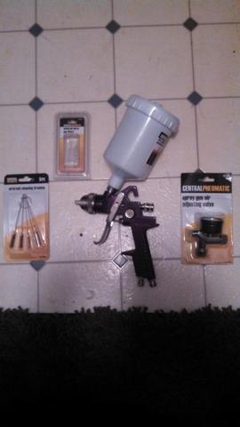

I sure will. She's a good one for sure. I couldn't ask for any better. I got some more goodies today from harbor freight. This gun feels surprisingly good in my hand and doesn't rattle or clank or feel like junk. I took the advice of all you guys on here and bought the $15 gun tonight. I can't wait to use it. I also bought cleaning brushes, extra gun filters, and a regulator. I was extremely happy.
post-11334-0-08173600-1384392872_thumb.j
Edited by zanepetty
  • Like 1

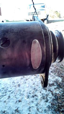

zanepetty
I primed a bunch of little pieces today. Heres the starter. I used the grinder and cup brush on it as well. I taped up the Delco tag. I'll take it back off when its time for clear. I think it will look nice with clear over it
post-11334-0-59538700-1384482052_thumb.j
Edited by zanepetty

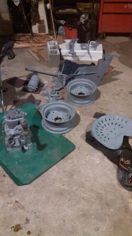

zanepetty
Here's what I got done today. I block sanded my dash tower starting with 320 and then 400 to make sure I got AAAAL the orange peel and gloss leaving it nice and matte for my red :) as for the rest of the parts here, I scotch padded them with red then with the super fine grey one, INCLUDING In between gear teeth and motor fins. Also before I primed them? I used a white rag and wiped them down with mineral spirits until the rag came out clean. It may be a little much but I want to make sure I protect my tractor for years to come plus make it look nice!
post-11334-0-01122800-1384562714_thumb.j
Edited by zanepetty
  • Like 1
speedyleedy
Look's great so your new spray worked good for you .
zanepetty
Well I didn't use it to spray that. I just sanded and scotch padded today. I used a friends gun for primer.
zanepetty
Should I paint my carb and fuel pump? I don't know if it will mess them up or not. I know I would have to plug up the holes if I did.

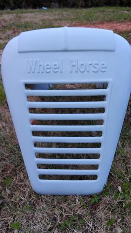

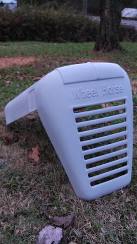

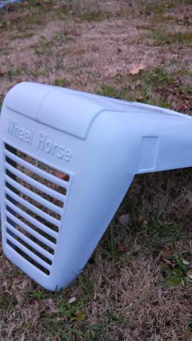

Finally got my hood ready for red. It had some dings, the grille was a little bent and it had two holes that I had welded up. Not rust holes. Just two holes. I have no idea how they got there, but I fixed all of it and put some etch primer then a few coats of high-build 2k urethane primer, then wet sanded all with 400. I'm pretty proud of the way it turned out
post-11334-0-07226500-1385070294_thumb.j
post-11334-0-20352200-1385070368_thumb.j
post-11334-0-96847700-1385070425_thumb.j
Edited by zanepetty
  • Like 3
kudzu3
You should be proud, looks real nice. :)
zanepetty
Thanks, tommy. I want to see your progress on yours!
Ken B
Looking good!
zanepetty
Thanks!
stevasaurus
That hood likes really nice Zane... :)
zanepetty
Thanks friend!

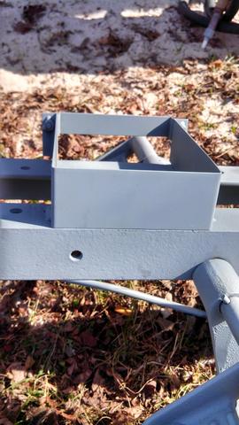

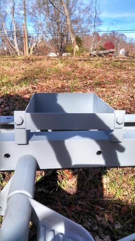

zanepetty
Here's the battery box after I had a local welding shop weld a new one on. They did a really good job.
post-11334-0-97180700-1385321119_thumb.j
post-11334-0-69611400-1385321135_thumb.j
kudzu3
Looks nice! Looks like you're gonna have one of the nicest tractors around. Your patience and attention to detail will pay off, can't wait to see the final results.
