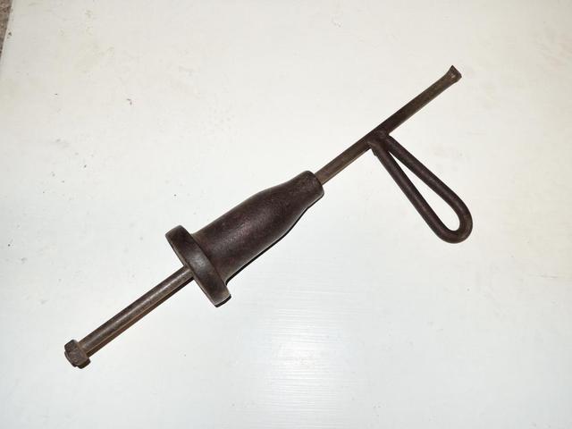

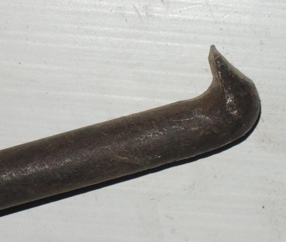

Here is the old slide hammer. I had actually forgotten that I had it.

tunahead72
Thanks for the photos, Bob, from another guy who's still learning.  Now, if you could show me how to actually use the contraption, my education will be complete!  Maybe a tech seminar at the big show next year?  :icecream:
You catch the edge of the inner race with the hook  in Bob's close up and slide the weight (hammer) towards the opposite end and bang it on the nut on the end of the shaft. Work your way around the bearing evenly until it pops out. The weight banging creates an abrupt force pulling the bearing.
rmaynard
That is correct. However, if you bring a transmission with you to the next show Ed, I will happily demonstrate.
