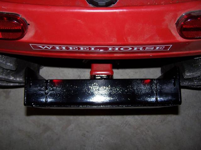

Here are a couple of photos of my latest attachment for Tom and Scott's 2" receiver hitch. I bought the Suitcase Weight bracket from Greg Parnow (Heavy Hitch.) It is a perfect match for the 2" hitch. It can hold up to six suitcase weights (43 lbs. each.) My Lowe's only had two in stock. This is on my C-105 which serves as my backup plow and general plow year-round. I needed some weight on the rear as both of my 5xis have wheel weights installed. Santa has indicated that "she" is bringing a pair of Ags for the C-105 this year!
On my shelf waiting for an install is the hitch for the 520-H that I received this week with the 2nd 5xi hitch close behind. Tom is also fabricating a receiver mount for my HF crane. I'll post pictures when I get it.
These really increase the versatility of the tractors.
Edited by shallowwatersailor

John, If I can ask you how much for the heavy hitch and suitcase weights?
Very nice set up indeed, I really like the way you rigged it up.
Ty, Glenn
Edit: ok I found the website and got the bracket price, now where do you find those weights? They look great.
Edited by JERSEYHAWG / Glenn

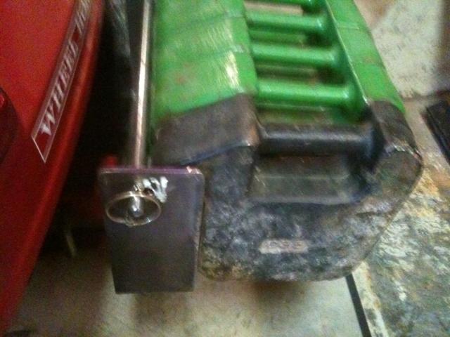

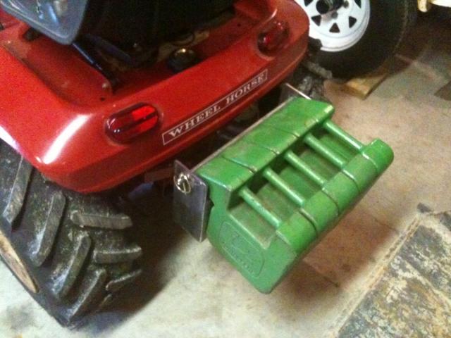

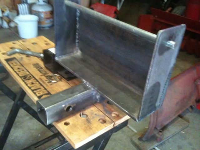

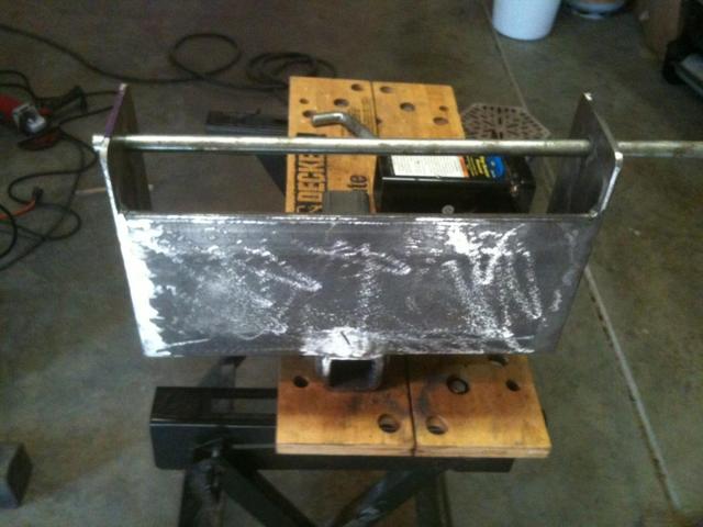

Attached are some pictures of weight bracket for 2" receiver hitch my son welded up last winter.
This one holds 5 40# weights.
We're going to make one for 6 weights next week.
Cost is approx. $30-$35.
Bought a bunch of suitcase weights when Lowes was clearing them out in our area several years ago.
Price varied from $10 to $20 each.
The green John Deere weights I got off Craigslist for $30 each, cost $55-$60 at John Deere.
I do have a Heavy Hitch for my Kubota BX2370, I can put 8 40# weights on it and use the weight bracket in the pictures to add another 200# for 520#.
Nice Job on the suite case weight mount! It looks great on my hitch! :happy-jumpeveryone:
