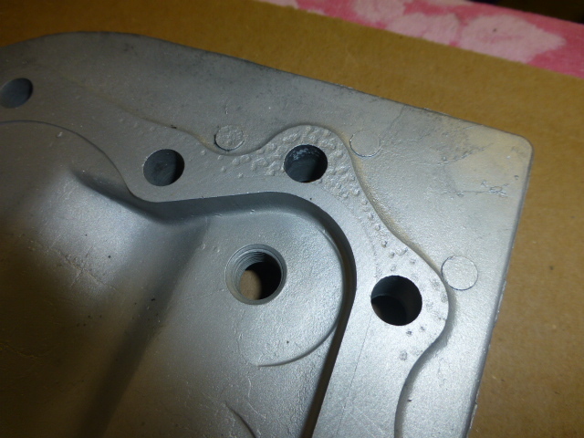

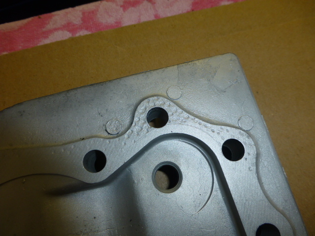

1st, while glassbeading the head, I found what appears to be an eroded away area on this corner of the gasket mating surface around the exhaust valve.   As you can see in the pictures, the area from the inside of the head bolt bore to the combustion chamber is fine.   Was just wondering if it's good to go or should I replace it?   Right now, only planning on doing the Figure 8 on the glass covered 600 wet to even the mating surface out.

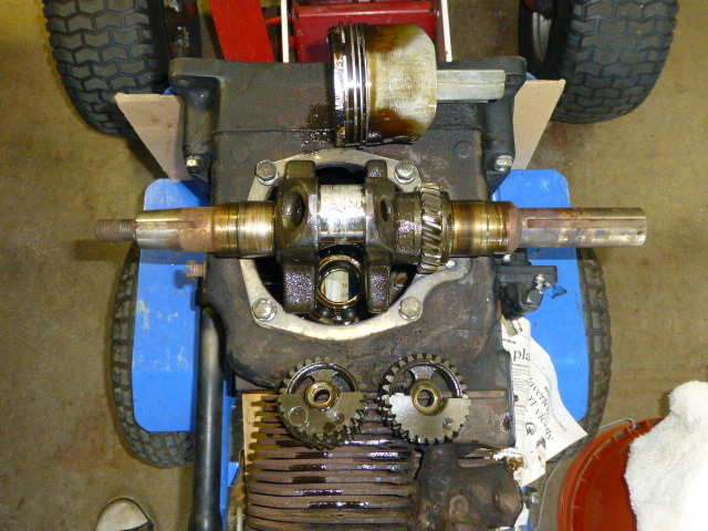

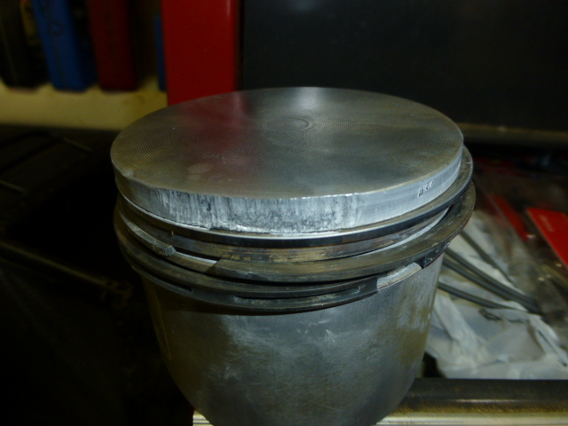

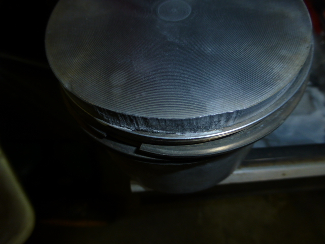

a:   2 pictures of the piston that came out of it.   The eroded area on the top edge was towards the valves.   The rest of the piston had normal wear.   I'm assuming that this may have been caused by pre-ignition.
b:   Also, just came from machine shop and he told me the exhaust valve seat spun when he tried to do the grind.   And, the exhaust valve stem was tapered from about 2/3 of the way up to almost the bottom of the head.

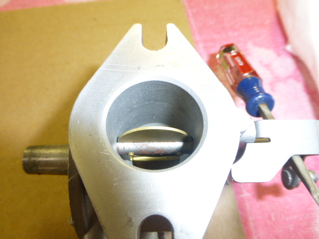

2nd question.   While cleaning the Kohler carb [has the main adjust needle just behind the throttle], I discovered a very small orifice [12 o'clock in the picture].   Can anyone identify it for me?   I tried following the casting on the outside, but that didn't go very far.   I know the other orfice [about 1 o'clock] is the air bleed for the idle mixture screw.   It would be helpful to know as I want to blow air through it to ensure it's clear, I just don't know where the air is supposed to come out at the other end.

That piston is no longer usable with the errosion you have.  This is caused by the engine not being decarboned at proper intervals, in addition to a ridge forming at the top of the cylinder bore.  Kohler says 500hrs, I say 250hrs max and I will be starting another thread explaining why with pics.  If you can spare the extra cash, go with a style d piston and narrow rod.  You will have better oil control, and most important, less bore wear over the life of the engine.  The style A pistons oval the bore out, and being the rings are thicker, creat more wear.
The machine shop will need to install a new valve seat and guide, as well as the valve itself getting replaced.  Quite common for those to loosen up on a high hour engine, but it is not normal for the seat to loosen up.
As for the carb, not sure.

Without seeing the whole engine its all a guess of course, but it looks to me like
you had a blown head gasket likely caused by a severely overheated engine.
Which would also cause valve and seat problems AND piston damage. piston looks like the material
was torn away rather than eroded due to expansion in that area, as it is where the combustion
chamber is. Hard to say if there was any preignition without seeing the rod and crank as it will usually
show up on the rod bearing surfaces and crank. Could have been as simple as clogged fins etc :handgestures-thumbupright:

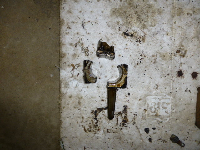

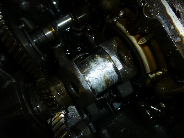

The head gasket didn't look bad / damaged or blown when I disassembled the engine, but this is my 1st Kohler, so maybe I wasn't sure of what to look for.
In addition to a new con rod, when I pulled the pistonand saw the damage, I wrote that off too.   The machine shop confirmed a new piston purchase in that the block needed an over bore of .010".   In addition, after cleaning up the crank throw, the machine shop saved it by turning it .010" under.   Both valve seats and guides were replaced, in addition to the valves also.   The previous piston and partial con rod now hold the honor of paper weight.

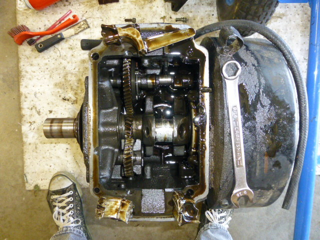

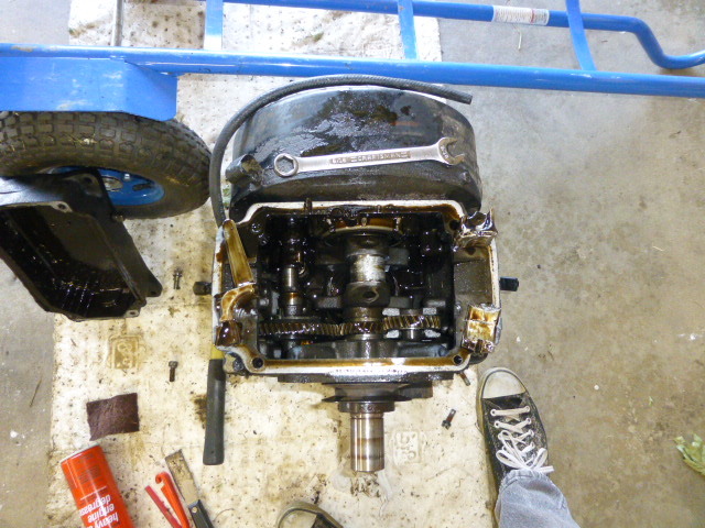

WH nut
Looks like it starved for oil and it got hot.
Chat6155
Story goes that 2 PO's ago was using it for snowblowing on a 312 the winter of '12-'13 and was a bit tardy on checking the oil.   PO was going to strip it for parts, but I picked it up complete just to rebuild it because I hadn't done one before.   Luckly, inside of block, cam, tappets and govenor were ok.

Are you going to put the balance gears back in?

Balance Gears; nope...after all I've read about them here, they, along with their clips, spacers, shims and the pins they rode on are now contently resting in a coffee can in the garage, probably never to see the spray of oil again [will fill the pin holes with 1/2" freeze plugs].   If worst comes to worst, I'll mount the engine on Isolator mounts.   But, as of now, the engine has no 'equipment destination'.   It's just a rebuild for the sake of self-induced learning.
