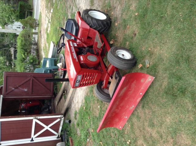

dose any one know if the raider series were supposed to be able to have plows? i have a 1971ish  raider 10 and i got a plow for it and the handle the afjust the angle of the plow hits the right foot rest. maby i have the wrong plow?

There are a few variations of the handle with different bends and even a straight one. I dont have a Raider but someone here will and should be able to tell you which handle will clear the footboards.
Mike...........
Kelly
Post a pic of the handle, some handles can be taken off turned around and have a notch to clear the foot rest, some you have to get a little mean with and put a bend in them, or you could have the wrong one all together, but that is just a handle swap not the whole blade.
The 1971 dozer blade came in 2 packages.
The blade

ok thanks guys
Humm
I got a Raider 12 last spring and had the same problem, I couldn't lock the plow to stay up. I found a longer linkage for lifting it in the bucket of parts I got with it ,and that did the trick.
raider10-8
yaaa that^ happened to me to but my problem is not the lifter its the angler handle. but i think if i take it off and reverse it like they said^^^^ i think that might work.
Humm
I just checked, it looks like a home made extension, about 3 inches.
