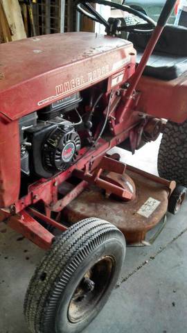

Xjchief 128 #1 Posted October 2, 2013 Swapped out the tired and broken tecumseh for the harbor freight 6.5hp predator. I know it seems kinda wrong to put a Chinese motor on an American tractor but it's a great option to get the tractor back to work. The swap was pretty easy, here are some pictures. Feel free to ask any specific questions if you are thinking about doing this. 5 Share this post Link to post Share on other sites
pfrederi 18,335 #4 Posted October 2, 2013 Nice installation... How thick are the two mounting plates you used?? Share this post Link to post Share on other sites
Xjchief 128 #5 Posted October 2, 2013 Thanks, I needed to go up 3/4" so i used 1/2" and 1/4" plate worked perfect plus added weight Share this post Link to post Share on other sites

woodchuckfarmer 333 #9 Posted October 3, 2013 Did you have to cut the hood to get it in? Share this post Link to post Share on other sites
Xjchief 128 #10 Posted October 3, 2013 Nope it just fit Share this post Link to post Share on other sites
ol550 830 #11 Posted October 3, 2013 What did you do for the exhaust exit? Share this post Link to post Share on other sites
Xjchief 128 #12 Posted October 3, 2013 The exhaust comes out behind the front of the hood but it's far enough back to not affect the paint on the hood or the decal up front either but my plan is to make a custom exhaust so I can go to a stack muffler Share this post Link to post Share on other sites

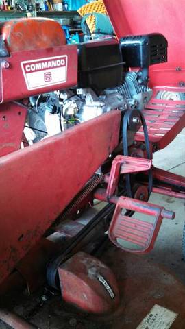

slammer302 2,156 #13 Posted October 13, 2013 I did the same thing on my dads commando 6 but I used the mounting plate from a b-80 gave me plenty room to move the motor around were I wanted it. I also hooked it up to the trailer I usually pull with the 856 let's just say the k181 keeps the front tires weighed down better Share this post Link to post Share on other sites
slammer302 2,156 #14 Posted October 13, 2013 Were did you get your pulley Share this post Link to post Share on other sites

Xjchief 128 #16 Posted October 13, 2013 Pulley is from a local electric motor repair shop. Share this post Link to post Share on other sites
