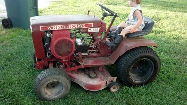

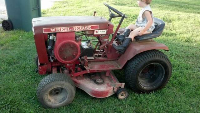

slammer302
I've done that with my b-80 my wife and kids call it the Franken Mower and its what I've used for all my mowing replaced all fuel lines put a carb kit in shifter boot coil pretty much all the basics I could park it in a junk yard and nobody would even give a second look even left the wheels rough looking
slammer302
Here is a pic

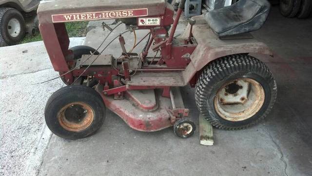

slammer302
This is it when I pulled it from a barn
Ken B
Taylor, that is exactly what I would do. Keep the patina look, I think you'll enjoy the tractor more. It looks pretty cool as it is, you'll save money and you won't have to worry about scratching it.

slammer302
No problem I did put some clear coat on the hood and fenders rust away
Uncle Buck
I would not clear coat it myself, nor would I paint it either. Make it right mecanically then have fun running it. You could always repaint it later too if you change your mind or get tired of the rust someday. Personally I like the way they look in their rusty workin clothes myself.
