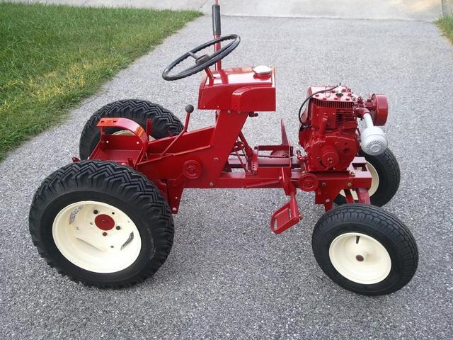

js5020
Heres my 16 Auto recently done in Regal Red and an original paint later model Toro Wheelhorse tall chute blower, no clue what the comparision to the other red would be,,,,,
http://IMG_3172_zpse4b9e63e.jpg
There is a shade or so difference but in person its not to far off.

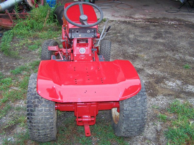

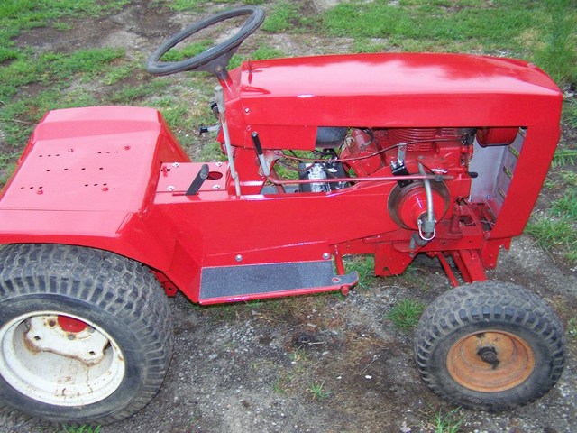

Done this so far with Rustoleum regal red...
post-5879-0-18023100-1379819375_thumb.jp
IMO sunrise red is just a tic brighter/lighter than regal red.

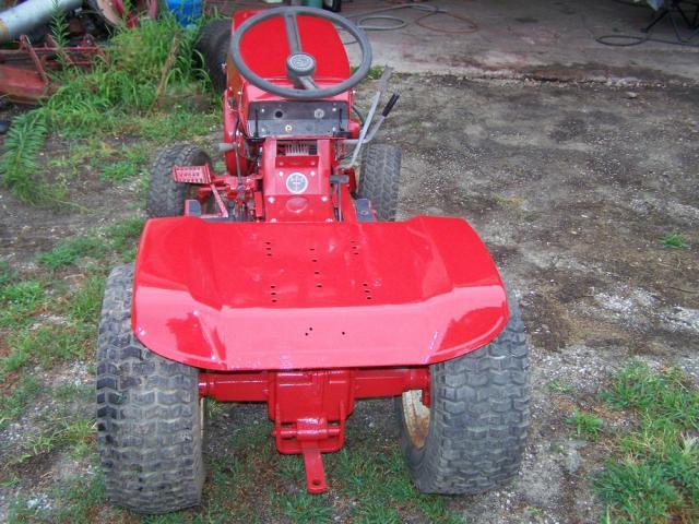

Well don't do 50% thinner that's about like spraying it with a garden hose. There is no way to stop any paint that thin from running. I am not a professional but I have sprayed a lot of paint.
Here is what I found, if it's 70 degrees or more I use very little thinner. Now you have to realize I do paint outside which does make a difference too. By outside I don't mean usually wide open as I paint in a big open door on my shop. I don't let the tractor sit outside and get hot before I paint either. I don't mix large batches of paint to start with. Depending on what I am painting I usually mix 4 or 8 oz. of paint. I use a measuring cup, For the Van Sickle paint I use, I put the paint in, then you add the hardener( in my case that is 1 oz for 8 oz. of paint ) and stir, let it sit for about 10 minutes covered, then I will add an ounce of thinner maybe less depending on the temp and stir it with a paint stick. When you pick the stick up out of the paint watch it run off the stick. If it looks too thick add a little more thinner until you are satisfied. Now you don't spray it on what you want to paint yet! Take a scrap piece of metal and shoot some on there, if the coverage looks good and it doesn't run you should be good to go. If your gun doesn't spray it good you have a couple choices. You can thin it a little more or increase your air pressure a little or adjust your spray pattern until it works for you.
Before you do any spraying with a gun though you should read as much as you can about the adjustments on your gun. If you have never used a gun before don't assume that you should just start with your newly restored tractor without practicing first. When it comes to painting even professionals have problems from time to time. Don't get in a hurry or discouraged when you get runs, orange peel or it is dull. You can always wet sand and put some more paint on it.
Take it slow and remember that old adage if you fail, try, try again you'll get the hang of it.
post-1334-0-43130300-1379847831_thumb.jp
post-1334-0-98257300-1379847854_thumb.jp
