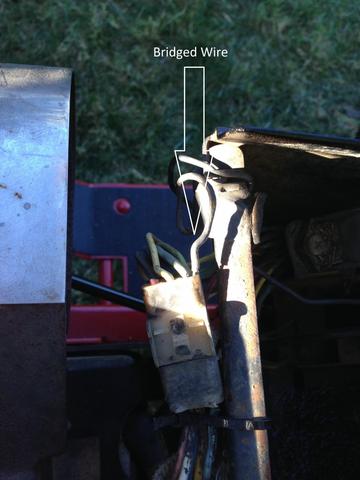

motox25 36 #1 Posted August 31, 2013 I've been digging into the 1991 520-H I purchased and have been restoring and ran into some electrical issues. First, the tractor starts and runs but none of the electrical gauges work and neither does the light panel. Upon digging deeper I found almost every safety switch has been bypassed and the tan wire off my ignition switch has been rerouted directly into the 9pin connector. The PO only left 1 of the fuses in the box and the other has been jumped by a piece of wiring, the 3rd fuse is missing altogether. Lastly, the 9 pin connector is melted and looks like it overheated. I've heard this can be caused by a dirty and corroded connection, what would prevent this from happening? Also, what do you guys recommend I do as far as replacing the 9 pin connector, should I simply replace it with another one or is there a better solution? Share this post Link to post Share on other sites

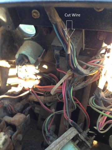

motox25 36 #6 Posted October 28, 2013 I got the 520 started today, without doing any work to the wiring except hitting all the connectors with contact cleaner. I purchased a new 9 pin connector and some dielectric grease to seal the connector. I do have a question I'm hoping someone can answer, like I said earlier there is a tan wire coming off the ignition switch which has been patched into the 9-pin connector with the blue wire going to the starter. I'm guessing this has been done to bypass all the safety switches? I have discovered my indicator lights actually are lighting up when the key is turned but none of the gauges are working. I see a cut tan wire going into the indicator light board, I'm assuming this is where I need to reattach the tan wire? Wanted to make sure before I burned something up The PTO wiring has been cut out, I'm assuming this will prevent the engine from starting once I reattach this tan wire? I'm going to try to salvage my fuse block by cleaning all the contacts and replacing the fuses, but will be buying a new block if that doesn't work. Share this post Link to post Share on other sites

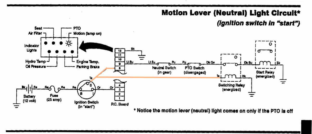

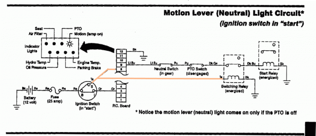

Save Old Iron 1,573 #10 Posted November 5, 2013 The tan wire from the ignition switch goes to 2 different locations. The S terminal will be powered by 12 volts when the ignition switch is in the START position. Power will be applied to the SWITCHING RELAY and also terminal 8 of the indicator module. It appears the 12 volt power then proceeds out of pin 9 of the indicator module to the safety switches on the seat and the PTO. Essentially the logic is the PTO switch, the seat switch and the SWITCHING RELAY all must have closed contacts to allow the 12 volts to power the START RELAY and therefore spin the starter motor. Trace out the TAN wiring to the indicator pod and the SWITCHING RELAY. If both these wires are correctly attached, then we can proceed to troubleshoot the no start crank issue on the tractor. Share this post Link to post Share on other sites
motox25 36 #11 Posted November 6, 2013 Thanks for your help, glad you said that I was honestly planning on packing my new 9 pin connector with dielectric grease. Hopefully after replacing the 9 pin connector and reconnecting the tan wire my gauges will start working again. Share this post Link to post Share on other sites
