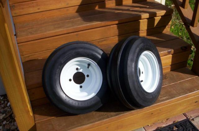

Digger, try this site>>http://www.millertire.com/products/lawn-garden-tires/16x6-50-8/16x6-50-8-firestone-3-rib-front-4-ply/
They are pretty beefy,  but look good on the ground, consider tubes, mine have difficulty sealing and didn't retry a sealing compound. These are on a four hole rim for a spindle hub.
Hope this is a kinda sota area you were askin'. There other pages have comparison info but tah tire you list sounds like a 15" rim possibly

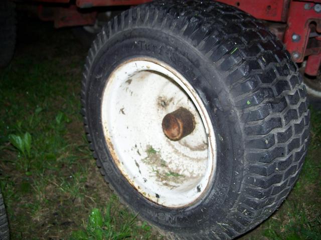

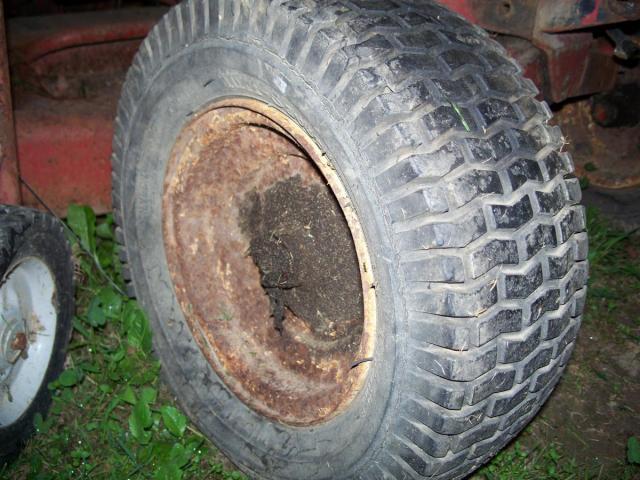

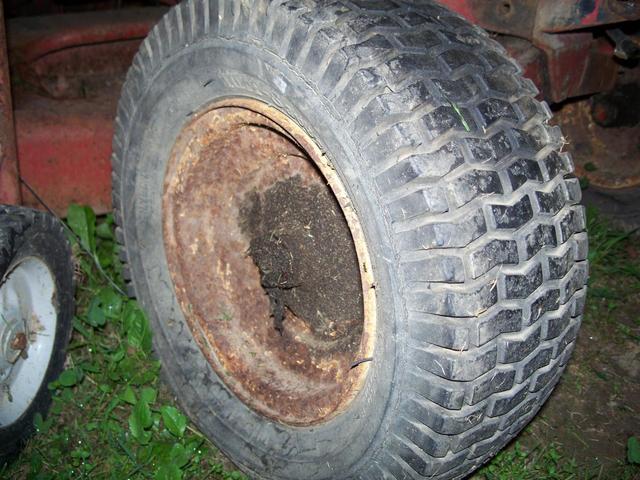

Kelly
your rims should look like this one but not as rusty, they are about 3 3/4" wide this one has a 16x6.50x8 tire on it.
this is the newer wide rim, it is about 5 3/8" wide it also has a 16x6.50x8 tire on it, the 4x8 tires will NOT work very well on these rims.
I'm 100% sure yours has the narrow rims, unless they have been changed

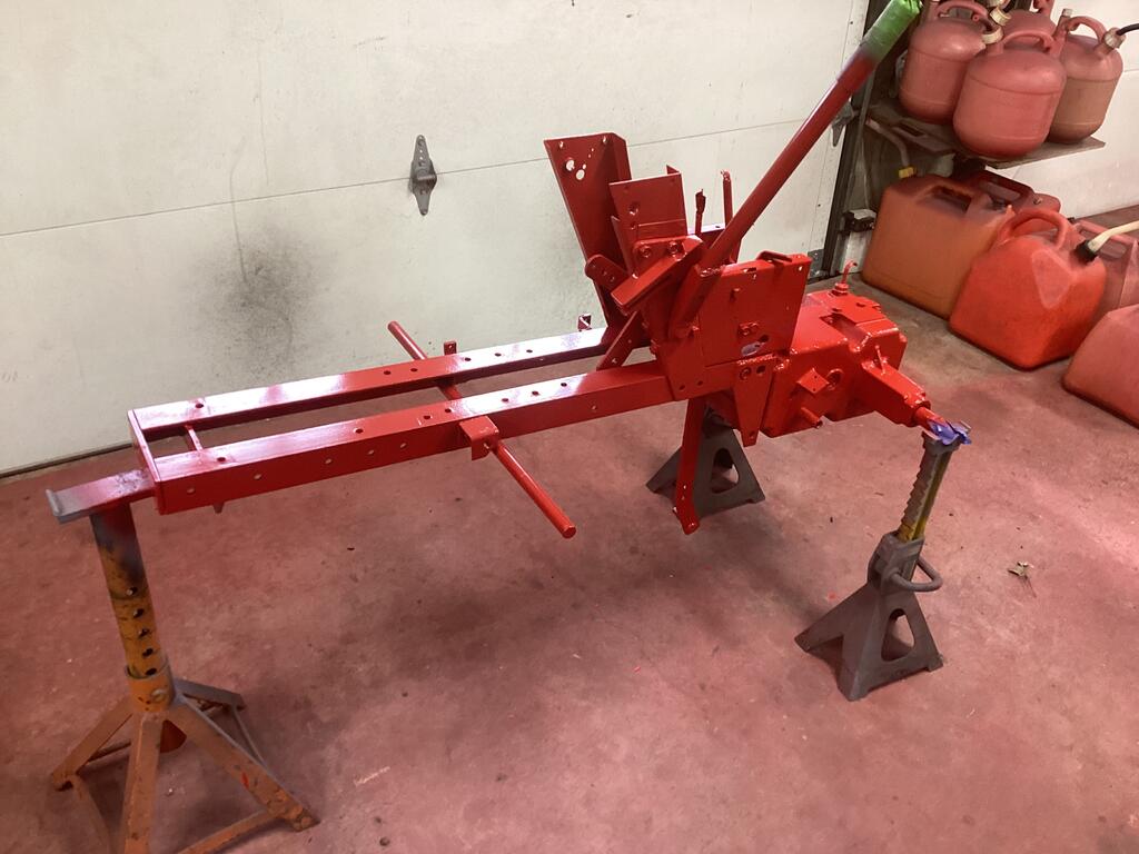

41chevy
I have the wider rim, it had one of each, A to Z only the wide so I bought that from Lincoln. I’m not going to work this tractor, I restored this one, it’s for my 8 year old grandson, I trying to give him the fever. 😂😂thanks
41chevy
Restoring now.
