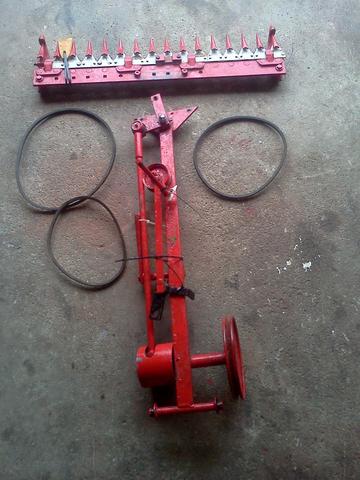

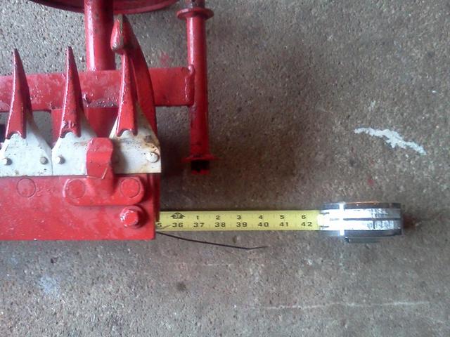

stevebo
Here are a few pics of one I have and am selling in the classified section :hide:

Curious... one bar holds 15 sections and the other 17?  I never went and looked at mine, but looking at Steve's above, I count 15, which is the same number allotted in the CBR-32 manual.  Not sure what the other one would fit.  I would guess it measures 34" wide? (they should be 2" each)
