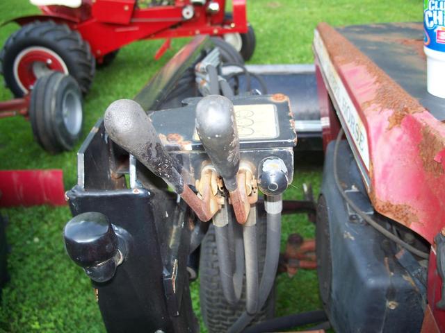

Kelly 1,030 #6 Posted August 8, 2013 The valve is on the spool valve/controls, mine faces the rear on the right side, with a cap over it, I had a hard time getting the cap off, they did not want joe blow messing with it, I can get a pic if needed. Share this post Link to post Share on other sites
Forest Road 594 #7 Posted August 8, 2013 (edited) I do believ I know what you're referring to. A pic would be great anytime. Unfortunately I won't be up there for a few weeks. Sending you a pm. Edited August 8, 2013 by Forest Road Share this post Link to post Share on other sites
Kelly 1,030 #8 Posted August 8, 2013 You can see the cap over the relief valve cap on the right. Share this post Link to post Share on other sites
Forest Road 594 #9 Posted August 8, 2013 Excellent! Thank you! Share this post Link to post Share on other sites
