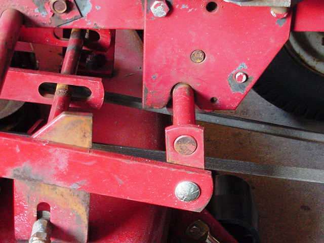

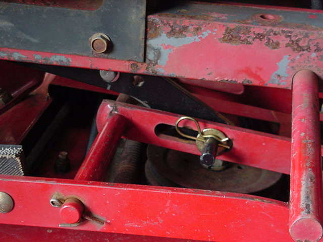

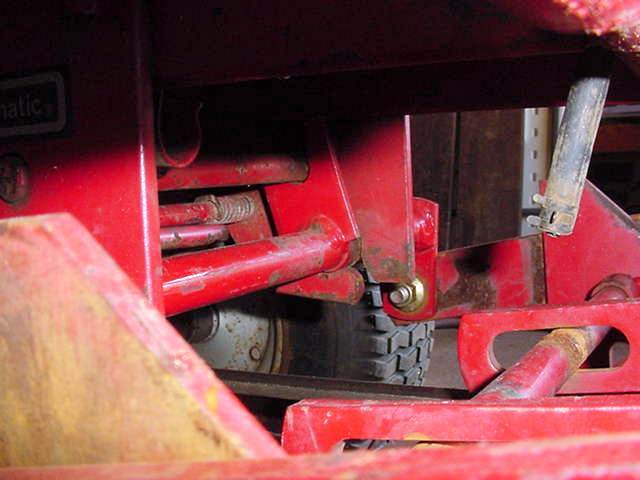

daveoman1966 3,866 #8 Posted July 20, 2013 Me thinks you don't have the deck connected properly. Here is what the 48" deck lift hdwe looks like. On the front of this hardware is a round bar with a yoke in it. That yoke MUST be positioned UP and slightly tilted FORWARD in order for it to engage a small GUIDE BAR that is on the mid Tach-o-Matic bracket tractor...between the side plates. This yoke is to position the deck so that it lifts evenly and to preclude back and forth movement of the deck. Share this post Link to post Share on other sites

waltsuz 12 #10 Posted July 20, 2013 Here's what I have: " Brand new parts" new lift bar and bushing for the left pivit point, new lift chain attachment eye bolt and trunion. The front fork is strattling the bar. I think its attached correctly. The lift assembly attached to the deck is loose and appears to be the way it works. I may try to video the operation of the lift to show whats going on. Its like the lift only picks up the right side. With it up maybe 5lbs of lift on the left side will rock the deck level. I really like this machine, I got a lot of work in it and it runs like new. I hope I can get this right..I really appreciate the help and suggestions, Walt Share this post Link to post Share on other sites
