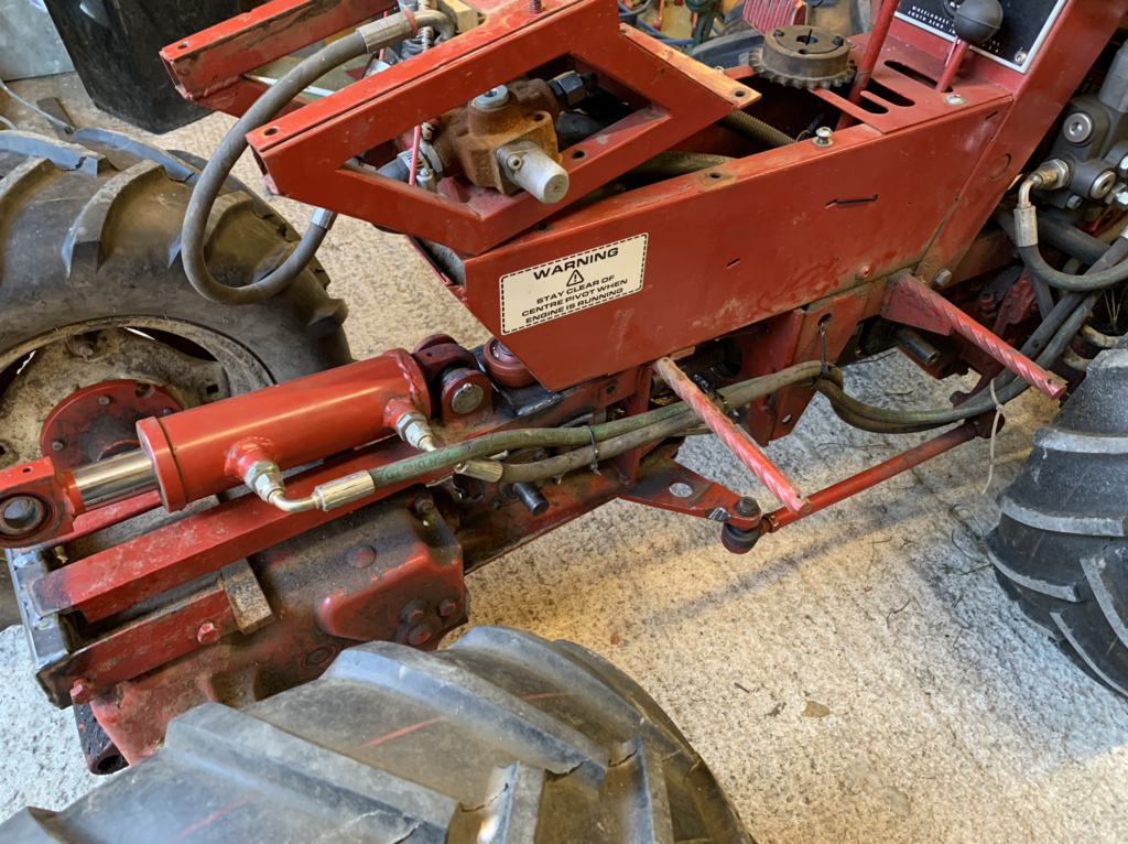

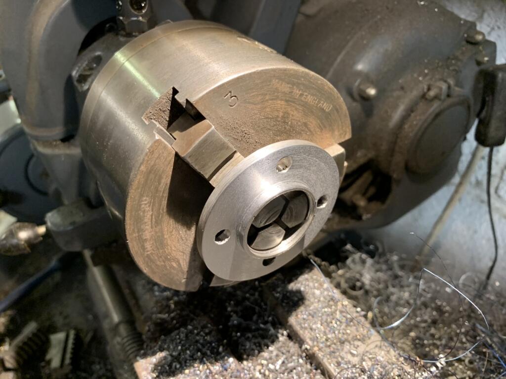

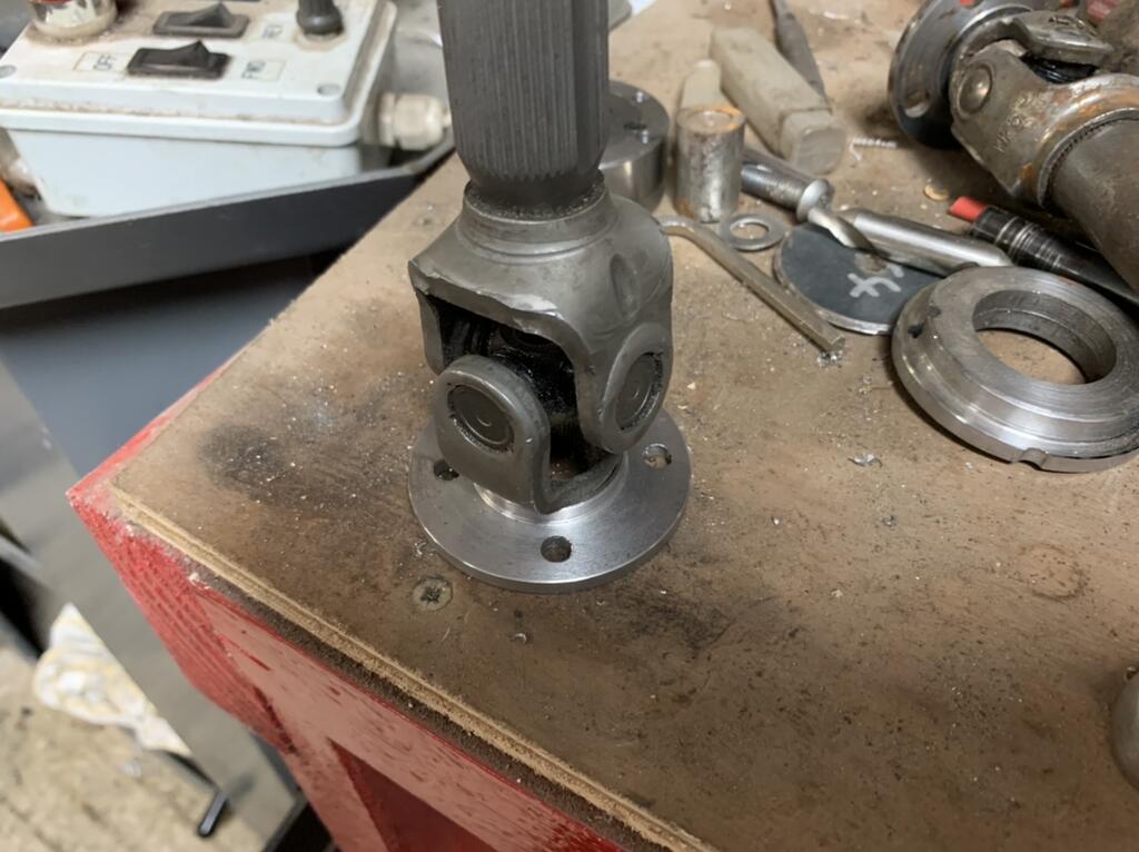

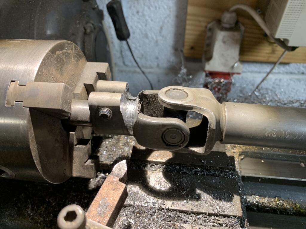

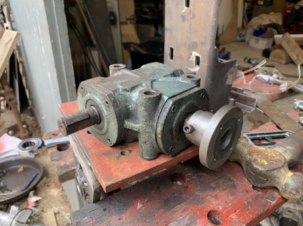

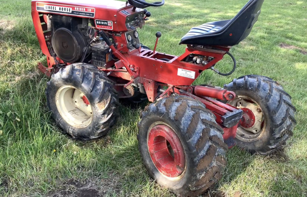

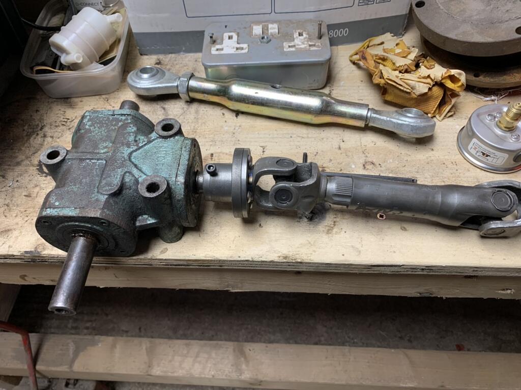

meadowfield 2,650 #276 Posted June 6, 2020 This has been a pita, changing the design on something after 5 years and trying not to take too much apart is hard! I’ve had to make a centre prop from a steering column, it’s small. Really tight on the splines and scales well. The downsize is the amount of effort machining... front 90 deg box with flange adapter fitted. Assembly dry run, needs a mount now for the front frame. 5 2 Share this post Link to post Share on other sites

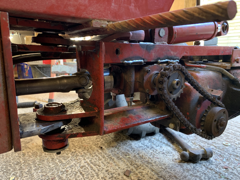

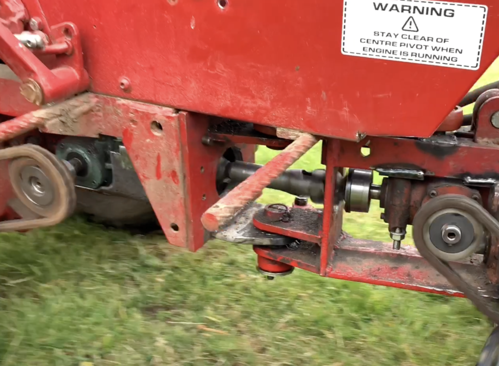

meadowfield 2,650 #277 Posted June 10, 2020 took a while an a lot of hacking, but we are done. had to reroute rear lift lines. action shot front hitch jammed into a banking to test and a short video 3 5 1 1 Share this post Link to post Share on other sites
