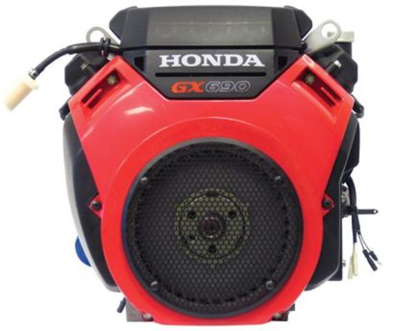

Wheelbearing 49 #1 Posted May 28, 2013 Alright I ordered it. Enough with my Onan bitching and moning. Honda GX690 22Hp. 1 Share this post Link to post Share on other sites

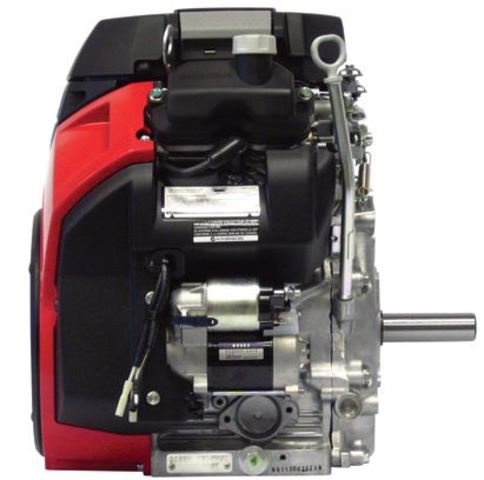

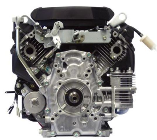

Wheelbearing 49 #4 Posted May 28, 2013 More pics. Interesting thing the Onan P220-G is 782cc @20Hp. The Honda is only 690cc @22Hp. Over head valves make all the difference. 1 Share this post Link to post Share on other sites
MalMac 1,332 #5 Posted May 28, 2013 Does the Honda have a roller main bearing on the PTO Side or sleeve type? Share this post Link to post Share on other sites
Wheelbearing 49 #6 Posted May 28, 2013 Does the Honda have a roller main bearing on the PTO Side or sleeve type? Ball bearings Share this post Link to post Share on other sites
MalMac 1,332 #7 Posted May 28, 2013 Thanks, after I posted I realized I said roller instead of ball. Never seen a engine with roller bearings. Share this post Link to post Share on other sites

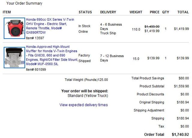

Wheelbearing 49 #16 Posted May 29, 2013 Have a 1991 520H - Onan engine valve seats gave up. Repowered it with a Honda GX670 - twin 24Hp 5-6 years ago. Mow with a 60 inch deck. It's a cutting fool! Its interesting Honda stopped making the 24hp gx670. Now they have a 660 they call 21Hp. and the 690 with 22Hp. I wonder if they over rated the 670 or under rated the 690. Or did Polution controls take the power away from the newer motors? I can't wait, I still don't have any tracking info. Northern tool says its being factory shipped. I have it being sent to my work because its being truck shipped. Share this post Link to post Share on other sites
