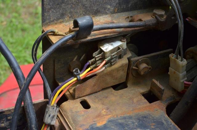

The PTO light on my console won't turn off and the engine won't start. While troubleshooting I disconnected the four wires from the pto switch but neglected to make note of which one goes where. Ooops. I have the wiring diagram but I'm not sure how to tell which connector on the switch corresponds to which wire on the diagram. I took a picture of how I connected it, can someone verify if this is correct?
post-9798-0-65663300-1369252669_thumb.jp

The way it's wired in the picture above is wrong. Tractor would start when key was turned to 'run'. I switched the orange and brown wires and now its correct.
