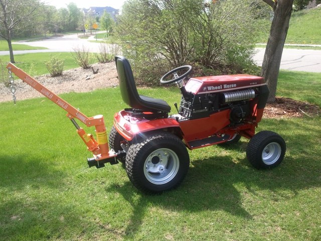

I picked up a 1987 418-A early this year and have been restoring it to do trailer and dock work at the cabin.  It will have an easy life from here...

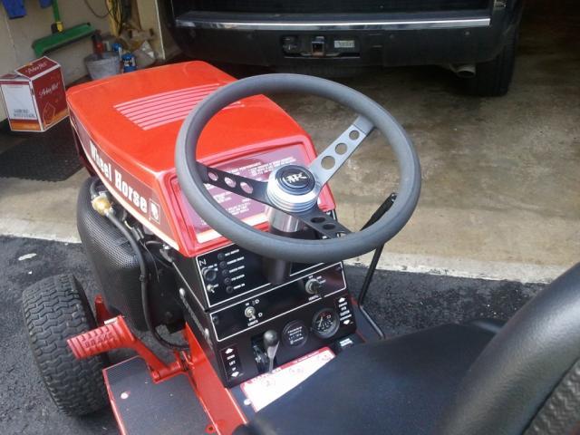

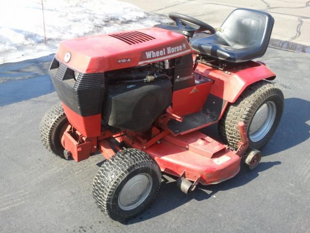

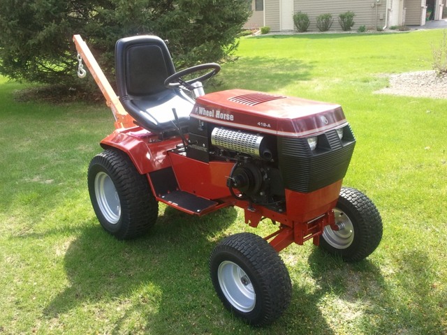

The 418 came with a boat steering wheel and the whole steering assembly had quite a bit of slop.  I replaced tie rods, added shims and tightened the fan gear steering shaft assembly.  I then machined a new steering hub to use an automotive steering wheel.
Here is the start with the before and after pictures. I'll add the steering hub assembly later.

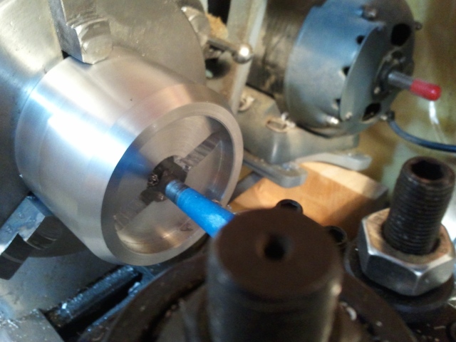

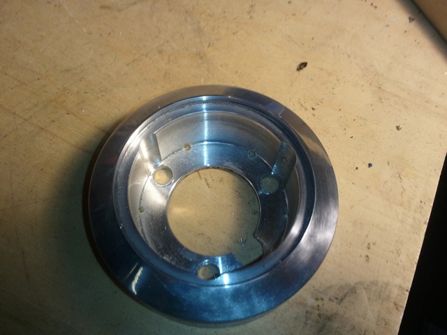

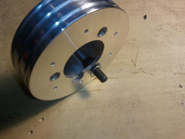

I machined a hub from 3" aluminum bar stock. This will go over the steering shaft and has a slot for the roll pin.  This way you can't see the pin and makes it very easy to replace the steering wheel in the future if needed.

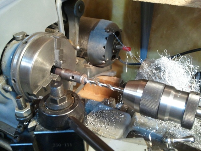

Catt

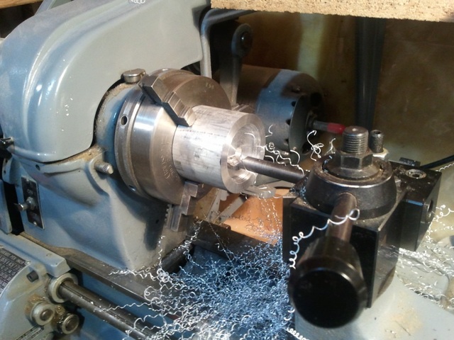

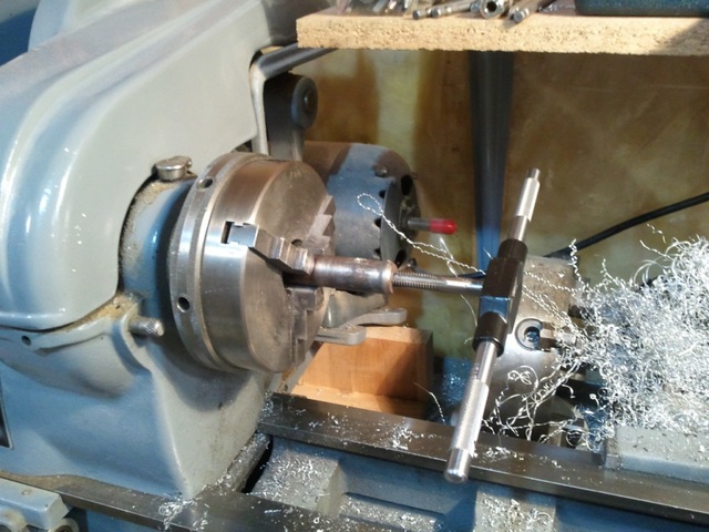

Now drill and tap the steering shaft.
post-9873-0-68514700-1368990565_thumb.jp
post-9873-0-70444600-1368990574_thumb.jp

Besides the steering wheel fab work the rest of the tractor looks awesome! Are you adding any front end weight to counterbalance whatever you pick up with the rear "crane"?
:WRS:
Mike............
Catt
Thanks Sparky!
I was thinking about buying a snow plow attachment. I would take off the the blade and use the plow frame... add a receiver hitch and the capability to add suitcase weights.  the receiver hitch at the end of the plow frame would be handy when moving trailers and would also have a hydraulic lift when connecting to a trailer.  I might build my own if it's not strong enough.

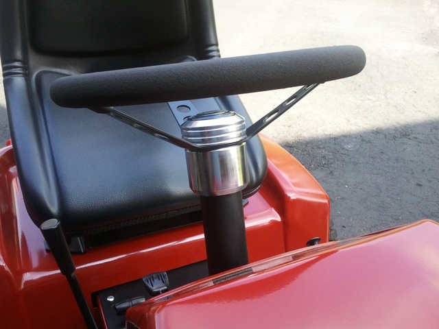

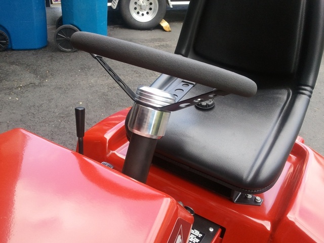

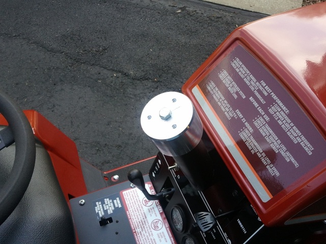

Here's the hub mounted to the tractor. The bolt holds the hub to the steering shaft.  The roll pin is hidden in a slot under the hub and is a tight fit.

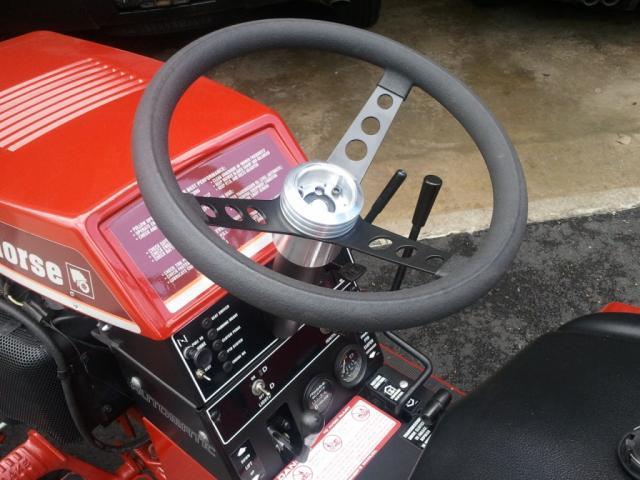

Catt
I bought a horn mount and drilled small drain holes and used a spacer washer in case any water gets in.
post-9873-0-46340100-1368997842_thumb.jp
post-9873-0-56092300-1368997854_thumb.jp
Catt
There is enough space for a key chain garage door opener. I would connect it to the horn switch. I considered a shorter height for the hub, but I like how it feels when sitting in the seat.

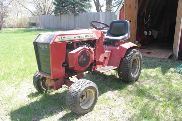

Catt
This is another project waiting for me to start, so I'll need more decals. It was my dad's C161 Twin Automatic Wheel Horse and has been sitting for several years. Still looks pretty good.
