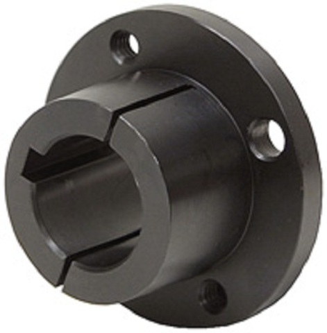

Could that be a pulley with a hub?

Are there any set screw holes at all ? I bet it's just rusted on. A bearing sep. behind that pulley and a puller hooked to the sep pushing on the shaft might get it off. I can't believe :wh: back in the 50's would let things get too complicated.

I have an engine pulley like that. Set screws are in the thicker portion and not in the grooves just like you said, so the set screws are not locking to the shaft in that scenario. Must be rust welded on there. Maybe they wedged something in there and hammered it on to keep it on the shaft. Looks like heat, hammer, puller and frustration time. Get'r Done!
