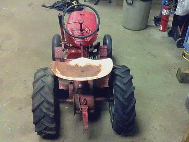

big mike 13 #3 Posted May 3, 2013 Pretty decent lookin' Horse!. I does look like it's not sure which way to go though Share this post Link to post Share on other sites

Luke 9 #5 Posted May 4, 2013 Pretty decent lookin' Horse!. I does look like it's not sure which way to go though I could say that I did that on purpose to help when backing up, but the truth is, I have two sets of rear wheels, with two good left wheels, and two bad right wheels. I simply put the two left wheels on the tractor for the time being. When I prep and paint the rims, I'll correct the tire. Share this post Link to post Share on other sites

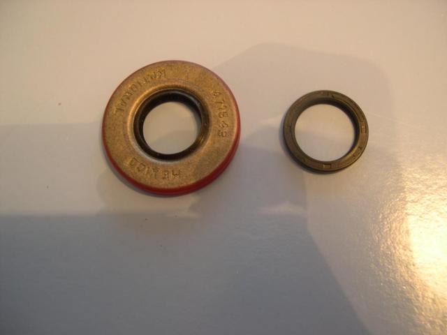

Luke 9 #10 Posted May 18, 2014 We've noticed a leak at the brake shaft. Trans fluid is leaking onto the brake band area. How do I fix it? Luke Share this post Link to post Share on other sites
Racinbob 13,112 #11 Posted May 18, 2014 Another seal Luke. There were two styles of bearings and seals on the brake shaft. If you have needle bearings you'll need a SKF 7410 (right seal in pic). If you have ball bearings it will be a Timkin 741643 (left seal). Pull the brake drum and it's easy to tell which you have. Again, this can be done without splitting the transmission. As already mentioned, stevasaurus rebuilds these things in his sleep and is always a great 'go-to' guy for help. That's do-say, not hear-say 1 Share this post Link to post Share on other sites
