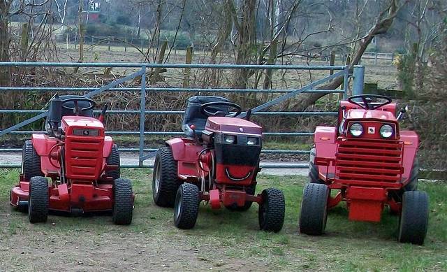

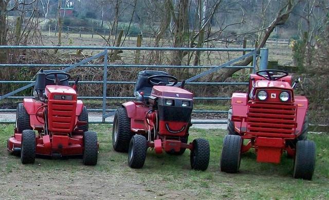

I'll get some photos of the 316 to add to the gallery - for now this is about the only one I have.
post-4509-0-97218600-1366486995_thumb.jp
Forgot to say that the 316 model in Europe had a smiley face.
