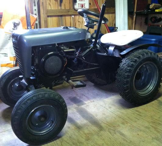

Trying to find out what year and model this is. My dad bout this in the 60' s sold it in 1983 and I just bought it back. Plan on restoring back close to original. But need to get more info. Are there numbers somewhere to tell me the year? I'm 99% sure it had a kouler 8 hp and I'm thinking from looking at pics a 1964/654 ??? Any help would be great.post-9975-0-68891400-1365460425_thumb.jp

A few more close-up pictures would help.

I will post some more pics but after searching around and knowing it was a kouler they made a 7 hp recoil and it has the same dash as the 1964 704. Where is the best place to get parts, paint, decals etc during my project???

Looks like a 704 to me

that would be a 63 or a 64 model. It does not have the original motor on it, but that is pretty close. It would of only had a recoil starter on it most likely so the one on it now has probably been added at some point. maybe a 604, 654 or a 704? 63 models I'm not sure of the models? Hope this is somewhat helpful, sorry I can't give you a answer for sure.

I know what its like to have your dads tractor. I have both my dads horses. his 1970 Raider 12 he give me in 2005 & I restored in 2006. & his 1963 753 that I grew up on. he sold when he bought the raider about 25 years ago. the hood that is on your tractor was used on the 604 654 & 704 for the year of 1964. The 604 & 654 used 6hp teckys the 704 used a 7hp kohler. the 8hp kohler was used on the 854 but would have a different hood. check the tag on the flywheel shroud a k161 would be a 7hp kohler & a k181 would be a 8hp kohler. if its a k161 & this is the original engine it would be a 704

If it had an 8 hp Kohler with electric start and was built in 1964, that would make it an 854. The original engine would have had a starter/generator and a belt to start it. It looks like you have a newer engine with a starter motor, not the generator. I'm sure more information will be forthcoming from the experts. :)

It cant be the original 7hp, they were recoil start

I'm probably all alone here, but I really like that paint scheme   :hide:   and the small racing steering wheel. I would be tempted to leave it as is and just bask in the fact that I own my dad's tractor regardless of the paint and motor.

Kinda looks like a 64 lawn ranger on big tires. But I cannot tell if the choke and throttle controls are push pull or levers.

Thanks for all the responses. I am ver excited to get started on it. The motor has been changed to a kouler electric start but was a pull originally. My father has been passed now for 18 years but have to make a visit to mom I think she may have the original paperwork that came with it as he threw nothing out. Ha ha. That and she still has the cart that went with it and told me she wants it out of her garage. :-) I will get some more pics posted so I know for all the knowledge her I'm getting the right parts. Thanks again
