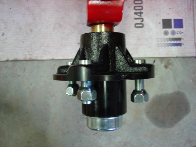

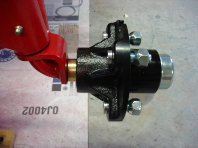

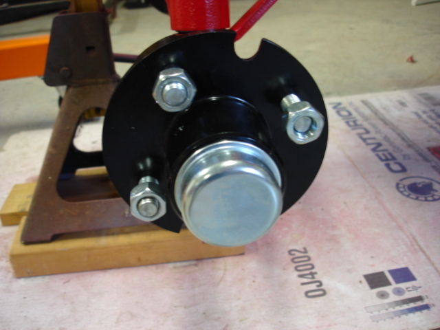

KC9KAS 4,744 #9 Posted May 4, 2013 Marv, that looks really nice. My D200 front-end needs attention too. I need to do something like this to mine. Great job and thanks for the photos. Did you make "new" spindels or re-do the old ones? Just what else did you have to do to make it work? Share this post Link to post Share on other sites
chrisd200(inactive) 56 #10 Posted May 4, 2013 Looks just awesome!!!!!! You have done a great job with this! What about where the spindle goes into the axle? Mine has a lot of wear there? Any thoughts? Share this post Link to post Share on other sites

Marv 991 #13 Posted May 5, 2013 Thank you all for your comments. It will be a while before I get the whole front end of the tractor back together as I have the engine, front grill frame, and other things apart. When it is all back together I will take a picture showing the wheels installed. The procedure went like this: I had the axle center pivot and spindle bores reamed and full length bushings installed (my friend has a machine shop and he is good). I installed new spindles (I have had those for a while). With a full length bushing, used spindles should work ok if they are not excessively worn. Since the axles are 1" and have no shoulder for a seal to ride on and the hubs are shorter than the axle I used spacers to set the wheel in position on the axle so I could preload the tapered bearings. This takes a little care as the spacers were 1" long and needed to be precisely fit. Trial and error length adjustment. These spacers also act as the surface for the hub seal to ride on.The spacers are bronze from McMasters-Carr part # 6381K212. The hubs came from Northern Tool, item # 57204. The wheels also came from Northern Tool, Item # 1226. With the new tires mounted on the wheels they look good. It is worth noting that the wheel offset with the set up I used fit perfectly. Marvin 2 Share this post Link to post Share on other sites
