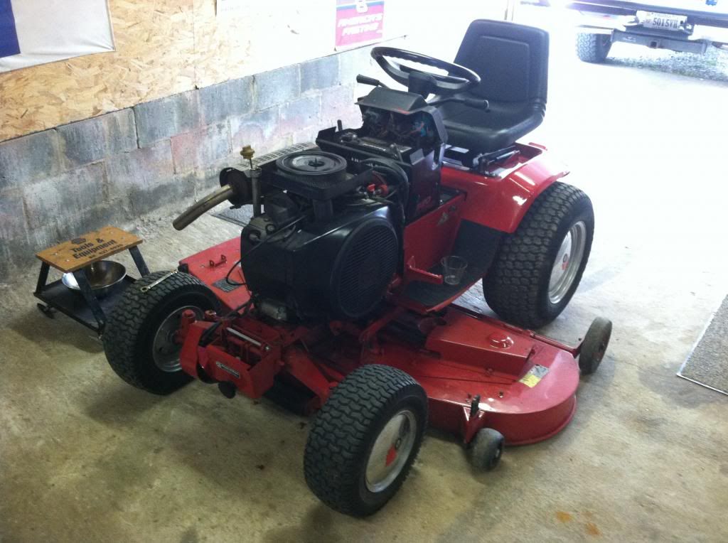

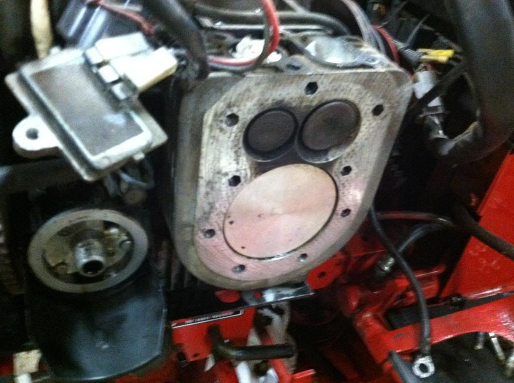

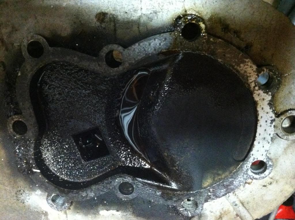

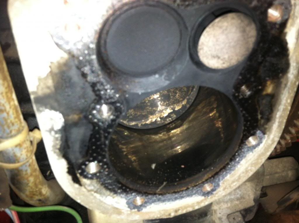

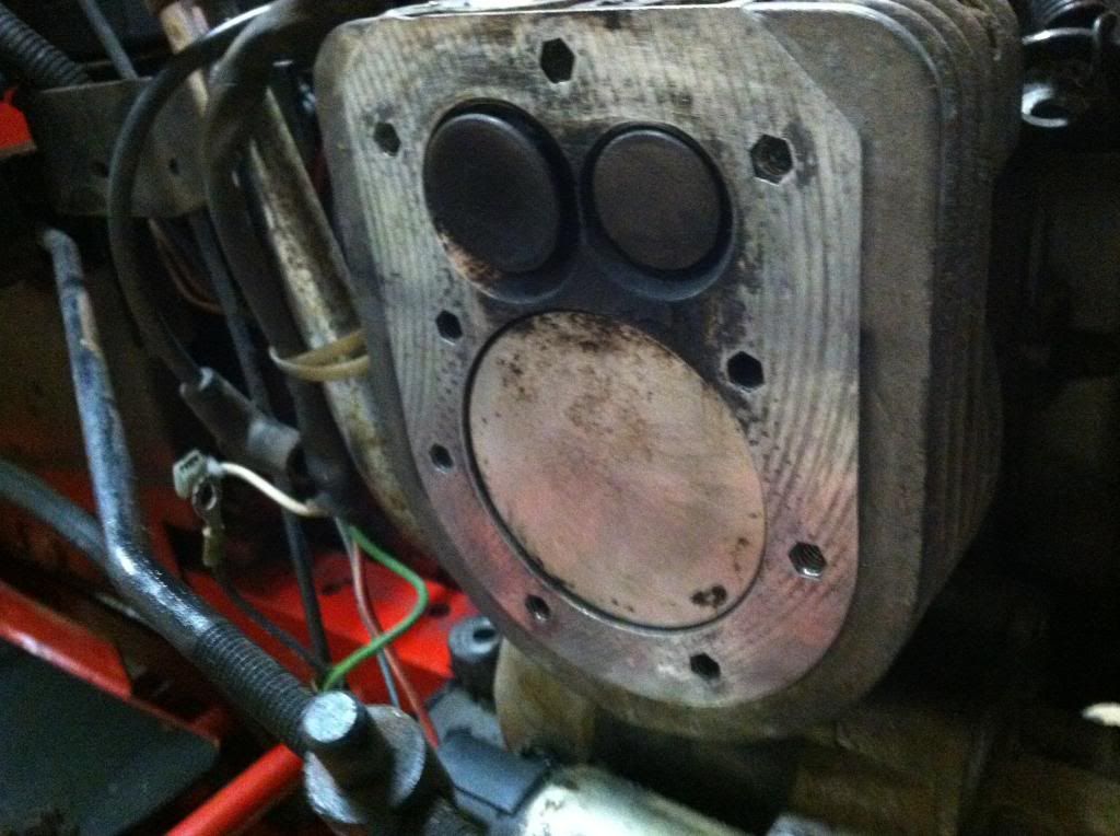

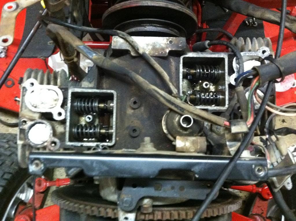

HokieAg07 129 #1 Posted March 3, 2013 Well today was the day to get the 520 ready for the season. Engine and trans oil changes, tune up, de-carbon the heads, and adjust the valves. This is the first time I have torn this tractor down since I got it last year. '96 model with 430 hours. Engine was very clean inside with so little carbon that some Gum Cutter and a towel removed it. Valves were out about 0.001-0.002. Did manage to break off a bolt in each head so that prevented me from getting done today. About the extent of the carbon in the heads Pistons/Valves Only took some solvent and a rag to get them clean Broke of bolts 2 Share this post Link to post Share on other sites

Wheelhorse84 87 #3 Posted March 3, 2013 So to do that job you need to remove all that stuff and engine? Share this post Link to post Share on other sites
HokieAg07 129 #4 Posted March 3, 2013 Only way to get to rear cylinder head Share this post Link to post Share on other sites
Wheelhorse84 87 #5 Posted March 3, 2013 Wow. I wonder how much the dealers charge for that job. Share this post Link to post Share on other sites
leeave96 496 #6 Posted March 3, 2013 I need to de-carb the heads on one of my 520H tractors and am not looking forward to it. I have a Kohler Command twin on another color tractor of mine and it seemed like every other bolt broke taking the tin off of it to get to the heads. I know the importance of decarbing the heads on these Onans, but fear, as you encountered, shearing a bolt and opening another can of worms. My gut says, if it ain't broke. don't fix it and I wonder to what extent one can deal with carbon with additives and leave a good running engine intact. I really like the Onans in my Wheelhorse tractors, but somehow if I blow one, I will likely replace it with a nicely rebuilt Kohler K or Magnum single cylinder cast iron engine. Good luck, Bill Share this post Link to post Share on other sites
MalMac 1,337 #7 Posted March 3, 2013 leeave96 I am right there with ya. I have got a 520 that needs to have all the de-carb thing done but I hate to tear it down. It is runnings so strong ever since I got the carb good and clean. The old adage If It ain't broke don't fix it keeps ringing in the back of my mine. It's kind of a catch 22 if you go and do the proper maintance you will cause more problems. If don't do the maintance you will cause problems down the road. I guess ethier way you gona have problems after all it's a Onan. Great motors till you work on them or don't work on them. I'll take my old K Kohler's any day. It's just hard to beat that Onan power though. Share this post Link to post Share on other sites
ericj 1,580 #8 Posted March 3, 2013 the problem with the bolts that broke off in the heads is that they don't go straight down in they go in on a slight angle so when you drill them out be careful, don't ask how i know this, but in the end it don't really matter because i have some heads that were drilled straight and retapped and works okay, but if you can do it right you should try. just a heads up eric j 1 Share this post Link to post Share on other sites
