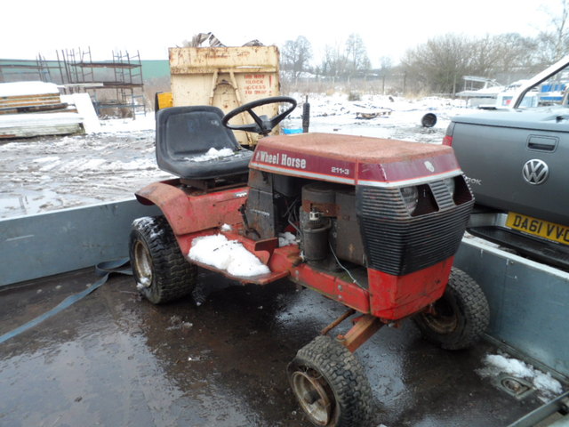

New to the site! Can any one identify the 2nd new addition?
jabba273
Hi Guys,
Can anyone help with this?
post-9248-0-69274200-1358955170_thumb.jp
post-9248-0-83743300-1358955145_thumb.jp
post-9248-0-90431400-1358955187_thumb.jp
The plan is to get the mower up to scratch and fully working order as a Mower for the old man (still need to find a mower deck!)
I would be very grateful for any info.
Cheers, James

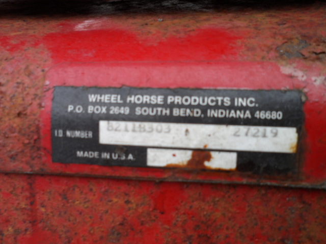

Hi James, 211-3 look's like was produced 85-86, but I can't match your Model number. Nearest I can find reads - 22-11B301 (1985) & 22-11B302 (86)?.
.................Maybe someone more familiar with this Model will be along to help you,

Can't read the model number. Looks like B2-11B303 or 32-11B303. Neither show up. Perhaps the numbers off the engine will help.

Strange can
I get that model number to match up exactly either. It may be easier to date it based on the numbers from the engine. This tractor should have the manual clutch for the PTO, they can be a little finicky, as far as decks go they either came with a 37" 2 bladed deck or a 42" rear discharge 3 blade. Some of the older ones coud have had a 36" 3 blade deck. The 37" is a good cutting deck and can be outfitted with a bagger without the need of an external blower unit.
Unfortunately the vertical shaft tractors use a different deck attachment system and there are far fewer of them around, at least here in the US anyways. The one big drawback on these tractors is the peerless transmission, not much good for anything other then cutting grass on the level if you have steep hills it will tear them up, believe me I found that out the hard way.

Welcome to the forum James.
I suspect the model number doesn't match theose given on the Toro site as it was an export spec for Europe. But try using the numbers that Richard's come up with.
Assuming the gearbox / transaxle is working that's a nice little first project to have a go at. Vertical shaft machines aren't popular but I have two in my stable and they work very hard.
These use a different deck to the horizontal shaft machines so take care when sourcing one - they do come up. They were found on 200 series tractors and the earlier B- series 'black hoods' I think.
I scrapped a 210 - 4 last year that was bought for spares, not the same model but a similar size so I may have some bits if you need them.

it's the modern (well a bit) equivalent of a B-111 or B-115. Circa 1985... Toro dropped the A/B/C prefix
try B2-11B301 which is a close equivalent on toro partfinder :D
Briggs serial number should help date at least the engine i.e. 252707-xxxx-xx

Here is a list of Mower Decks that should fit your 211-3 Tractor. Finding one will be a challenge, as very few sellers know what fits what Tractor, but at least you can ask for the Model number to check it.
05-32SB06 32" Side Discharge Mower
05-36XR05 36" Rear Discharge Mower
05-37MS06 37" Side Discharge Mower
05-42SB05 42" Side Discharge Mower
05-42XR06 42" Rear Discharge Mower

Hi James, Well I think Chris is your 'End of the Rainbow Pot of Gold'. I've been doing some digging for you and Chris' Deck is a 1980 model and is the predecessor of the Model number 5-42XR06.
The deck that Chris has was fitted to either B-112, B-115 and B165 Twin. All had B&S Vertical shafts.
Toro Partsviewer ( https://lookup3.toro.com/partdex/index.cfm?xCaller=Toro&lang=us_en ) shows all the same basic design and components for both 1980 and 1986 deck models.
All you need to do now is check with the IPLs (Illustrated Parts List) on Toro's site and match your Tractor's physical appearance and fittings using the Tractor Model numbers I gave in the earlier post.
If they match up well and you have all the Attachment lift parts on your Tractor, you will then know what you have or if you are missing anything to fit the Deck.
You will then also have all the Drive Belt (Toro) part numbers you may need, and we can then find the correct Aftermarket sizes if you prefer them.
Hope this Helps and keep us posted on your progress.
Well done Chris, I think you may have made James a happy man.
