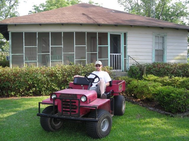

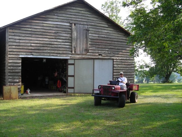

wp205a 43 #10 Posted January 23, 2013 Here's my Kimball Hauler. Not the best design, but it is perfect in the pecan orchard. 2 Share this post Link to post Share on other sites
wp205a 43 #11 Posted January 23, 2013 (edited) I'd take that clutch apart, even though it looks good, and stretch the spring to a 4" length and grease the ball bearings. Mine didn't engage good, did that now it's perfect. Powertech is my parts source too. Edited January 23, 2013 by wp205a Share this post Link to post Share on other sites
Rollerman 291 #12 Posted January 23, 2013 Thanks for the pics "WP205a", those later Kimball Haulers are nice. I probably won't mess with the drive clutch other than to put it on & see how everyting works first. The driven clutch will be getting rebuilt. Not much for updates, waiting on more parts to come in & the cold temps are keeping me out of the shop. I really miss the woodburner in my old shop. 1 Share this post Link to post Share on other sites
