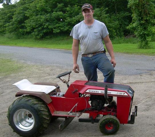

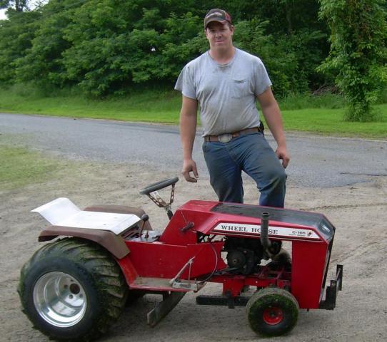

TT-(Moderator) 1,147 #6 Posted January 6, 2013 I firmly believe that proper hitch design and weight placement is much more important on a stock tractor. I know, I know..... it's all about the 'look'. I used an axle from a B series LAWN tractor, C series spindles, and 6" front wheels with triple-ribs on an old Raider I stuck together for the fun of it. (rear tires are 23-10.50X12) Here's a video of my son putting it to work: For all of you non-believers ~ that's just a stock 10hp HH-100 Tecumseh with a straight pipe. :P Share this post Link to post Share on other sites

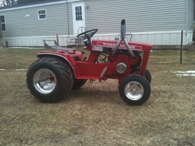

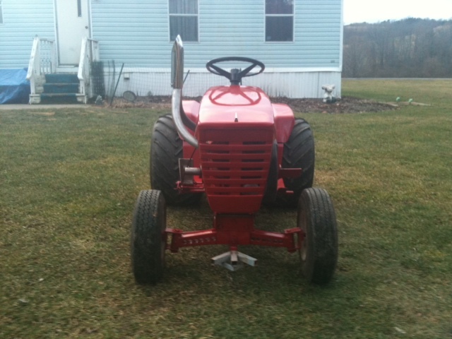

baerpath 517 #8 Posted January 7, 2013 This has a 200 series front axle with 4 inch tri ribs. Share this post Link to post Share on other sites
