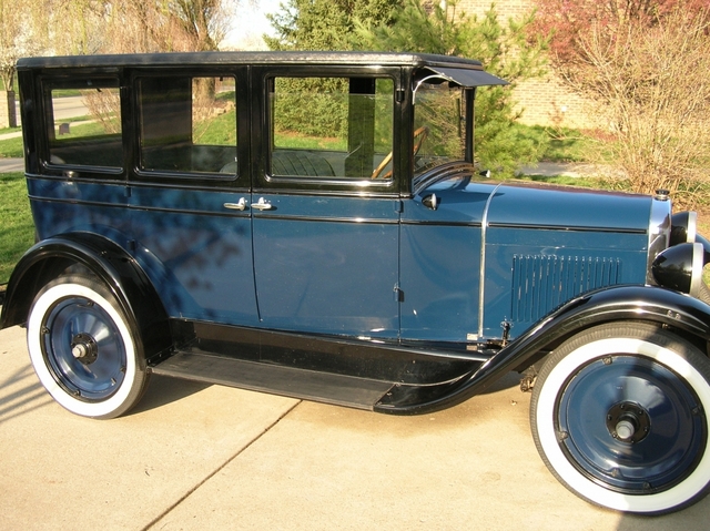

This 1927 Chevrolet
post-8847-0-61557100-1354736393_thumb.jp
pfrederi
Really Nice car. WHs are just like farm tractors of older days dead stop required to shift.
Nice Chebby Ken, what's the story with that little honey...original to your family?
KEN NABER
Bought it from a guy in kentucky 8 yrs ago, cleaned it up put a trans and clutch and motor work some pait and wal lah
stevasaurus
Beautiful car Ken...is that considered a station wagon? :) Ya...we have to get together...show you my 64' Ford.... :bow-blue:
