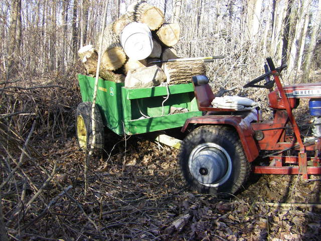

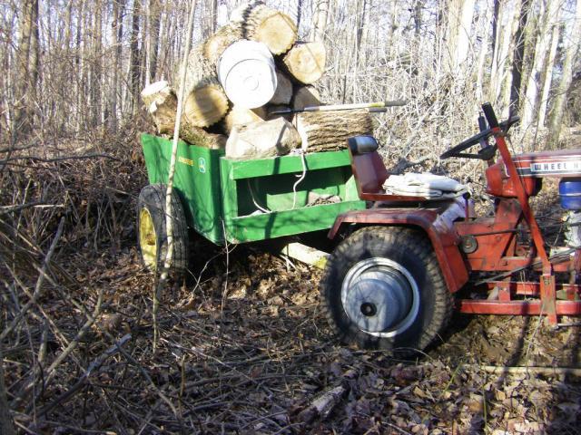

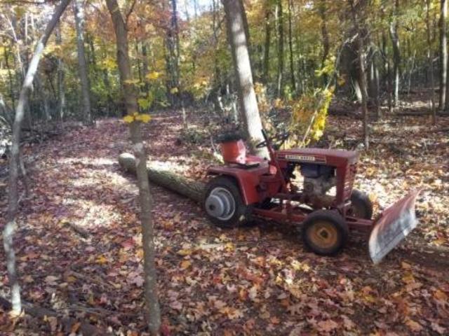

Hi: This is Mike Grubb. I was Google searching my WHEEL WEIGHT ADAPTERS today and saw this. I have 4 Wheel Horses along with 11 other brands (and still growing) I like to collect. I think my feedback says it all. People who buy them have very positive things to say. Contact me direct through wheelhorseforum.com (mgrubb47122) or mgrubb@aye.net and I'll knock five dollars off to mail them and fifteen dollars off if you pick them up. Great web site. Thanks for the good publicity. Mike G.
BTW: The one that started it all is a 1966 model 856 that my uncle purchased from Ken Shourds Ford Tractor Sales in Rockport Indiana when I was 11 years old. I'm still clearing snow, grading our gravel driveway, and hauling firewood regularly with it. I recently bought an 857 and repowered it just so I could retire this guy long enough to restore it. That's it in the eBay ads.
