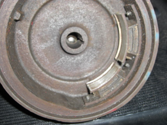

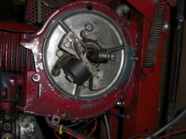

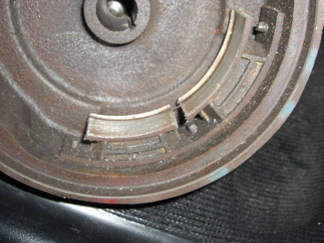

KEN NABER 28 #15 Posted November 26, 2012 here is mine mine looks different comments please Share this post Link to post Share on other sites
buckrancher 2,694 #16 Posted November 26, 2012 I hope TT chimes in I have not seen one like that Brian Share this post Link to post Share on other sites
KEN NABER 28 #17 Posted November 26, 2012 any way of getting a replacement ? someone sell this item? Share this post Link to post Share on other sites
buckrancher 2,694 #18 Posted November 26, 2012 I may have a good used one I will look Brian 1 Share this post Link to post Share on other sites

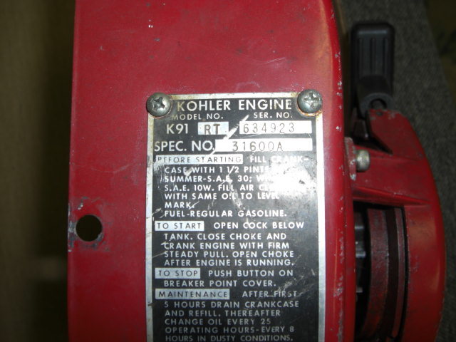

TT-(Moderator) 1,147 #19 Posted November 27, 2012 I had a 1979 K-91 that I believe had that magnet style. (been a while ~ sorry I can't quite remember) @Ken: can you post the spec and serial number from your engine, and/or does it have a silver ID sticker vs. a metal tag? 1 Share this post Link to post Share on other sites

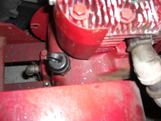

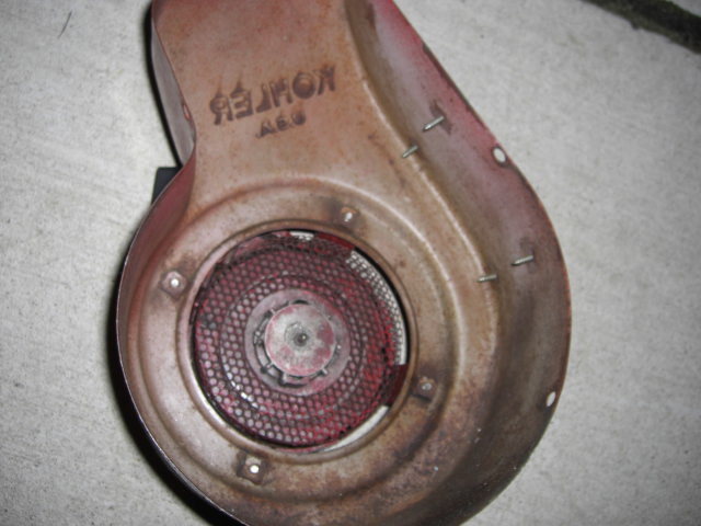

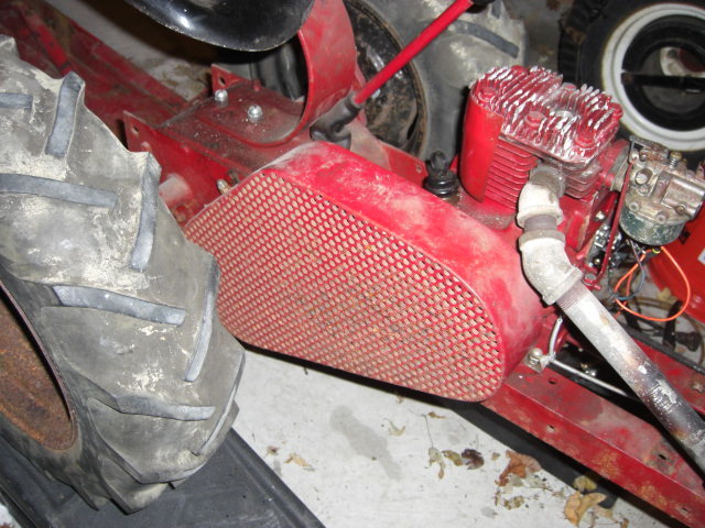

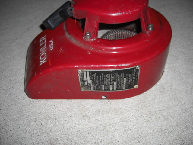

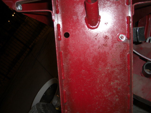

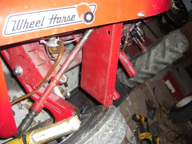

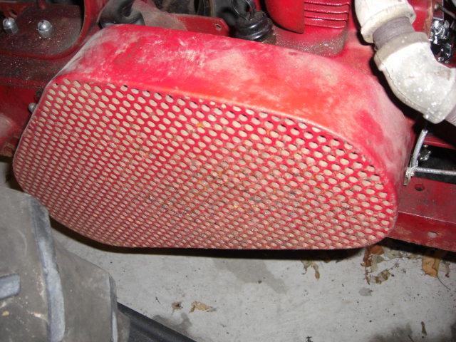

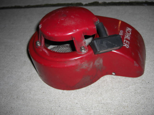

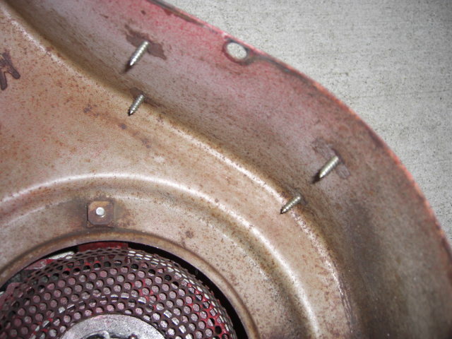

KEN NABER 28 #20 Posted November 27, 2012 Here are some pics, also note that hood support has no accomodation for the sector stop arc device, also the pulley guard does not expose pulley for implement drive, also the pulleys seem large. are these factory or homebuilt? Share this post Link to post Share on other sites
KEN NABER 28 #21 Posted November 27, 2012 pic with numbers Share this post Link to post Share on other sites
TT-(Moderator) 1,147 #22 Posted November 27, 2012 That wrecks that idea...... that tag is from a K-91 with gear reduction. (apparently from an Eska snowblower) Do you have pictures of the magneto? The hoodstand is a 'home-built' replacement. Not a bad job either, but definitely not OEM. 1 Share this post Link to post Share on other sites

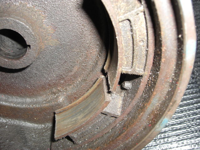

KEN NABER 28 #23 Posted November 27, 2012 here ya go! thanks for your help!!! Share this post Link to post Share on other sites
