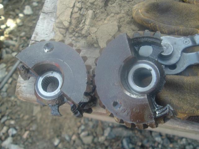

How did you remove the gears? Did you break them with a hammer? Or take the whole motor apart? Did you need many new gaskets. Any tips?
Tom
3609horse

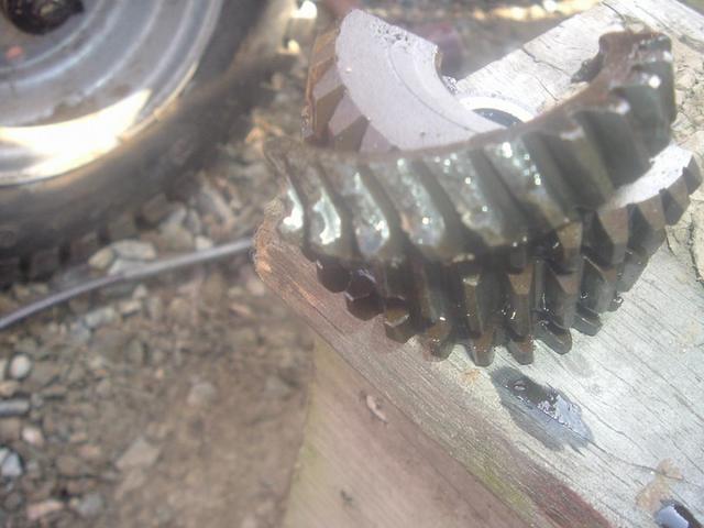

Tom, I removed the pan then took out the the two snap rings and yes I used a hammer and chisel and broke the thin part of the gears, all it took was one shot and they broke
nice and clean. Removed the thicker halves and made a new gasket put it together and it runs great. Its not that bad to do, I think the hardest part was taking off the upper snap
ring off, but not that bad I'm just bad with them to begin with, lol.
I took a picture of the gears after they were out so you can see, They were missing needle bearings and one had worn teeth, I think I got it out
just in time. Good luck with yours.

Great find, close call :handgestures-thumbupright: What did the oil pan look like with all that metal? I am putting my K321 back together this weekend and the balance gears will be left out for sure. (they look OK, but don't want to push it)
3609horse
The oil in the bottom was a little metalic but no chunks. I will run this new oil for a bit then change it again just to make sure all the metal is out.

Hey Gene, do appreciate this pic. (similar problem not yet finished investigatin'). Didn't quite understand how to break a gear (cast iorn I guess). Doesn't appear so difficult now, Thanks
