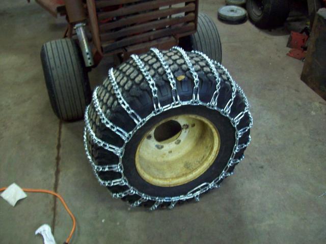

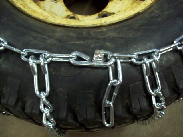

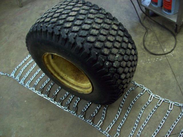

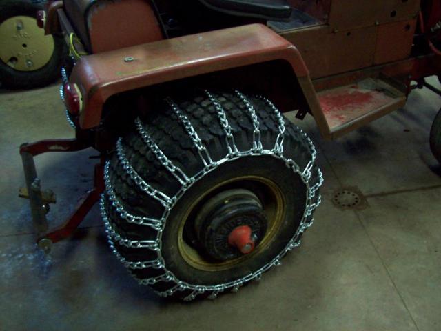

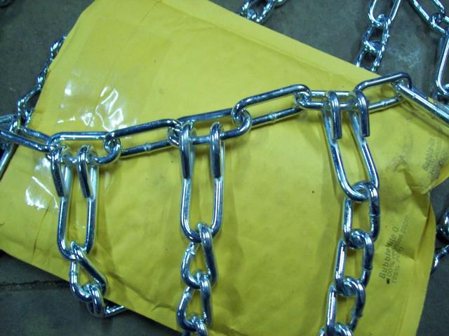

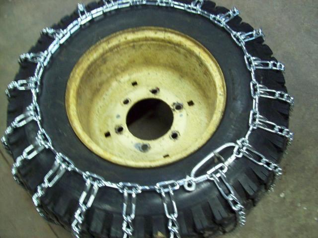

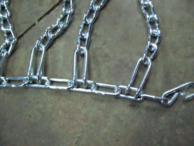

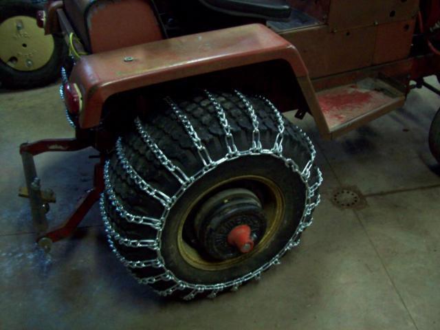

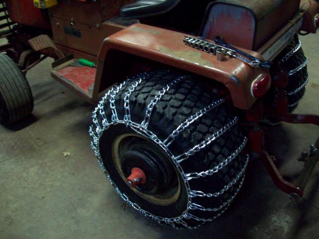

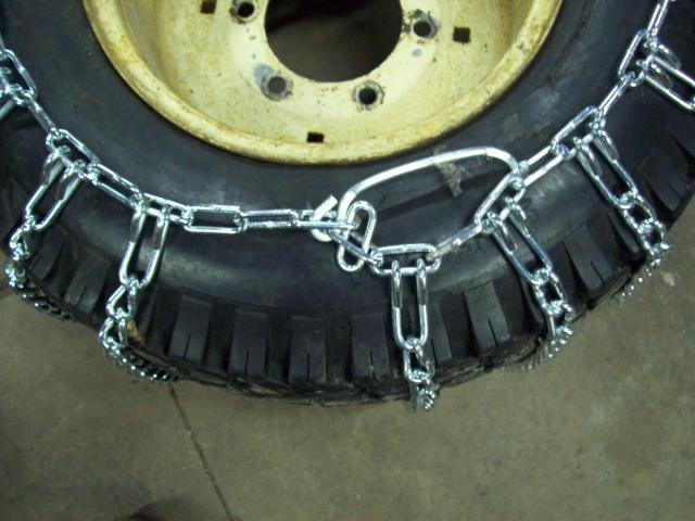

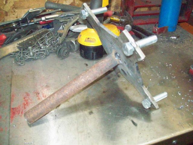

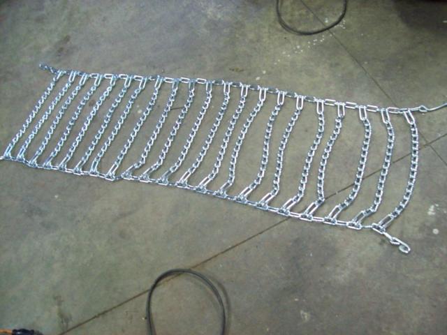

1maidenfan 202 #1 Posted October 28, 2012 Ok, here is my way of installing tire chains start by laying out the chain, making sure the cross chain tie links are facing down(see pic 1 ,2 and 3) Set tire on chains(remove air from tire, as much as possible) and wrap chain around tire and loosly attach tighting bar.(see pic # 5) Flip tire over and connect oposite site as tight as possible.(see pic # 6) Now flip tire back over and tighten other side as tight as possible.(pic # 7) Now adjust cross links so they are straight across from each other.(pic #8) Now air up tire and your done, well mount back on tractor, then your done. Pix # 9 and # 10 are of tires mounted with weights(home made brackets) 4 Share this post Link to post Share on other sites
