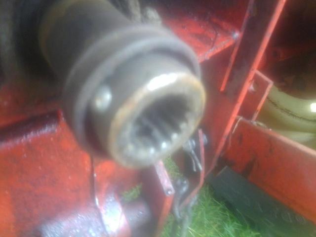

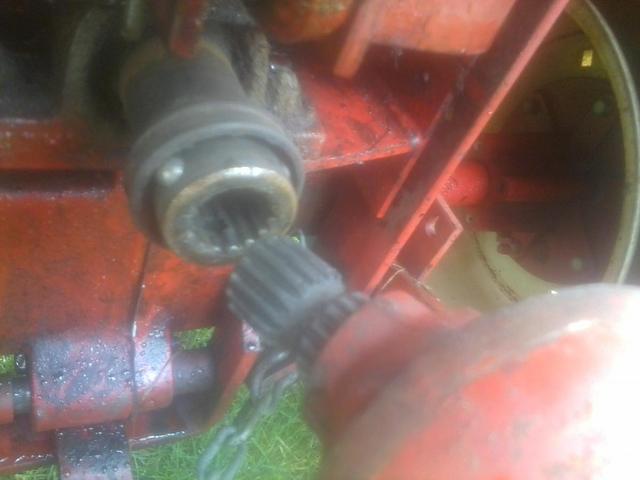

I just attached the Tiller and noticed the PTO shaft does not seem to have a way to stay fixed to the tractor.
I must be missing a piece. :sad:
Does anyone know what the piece is called or the part number? :tools-wrench:
Please bear with me as I am very new and have a lot to learn to pass on. :thumbs:
post-8758-0-20289000-1350749606_thumb.jp
post-8758-0-73933400-1350749611_thumb.jp
post-8758-0-42691200-1350749617_thumb.jp
otrelwood
that collar on the hub on the tractor part of the shaft slides back to hold those balls in the grove on the pto male part of the shaft so it wont slide out if its stuck spray it down with wd40 -pb blaster tap lightly with a hammer to get it to slide back and forth and have fun

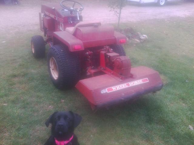

Looking at the last pic of the three, you might actually have an 18 auto and not a D180. Pretty much the same tractor with just minor differences.
Looks good!

HAHA i feel dumb the collar just slides over to hold it in place! gosh golly!

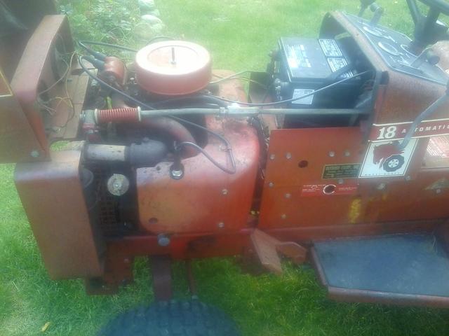

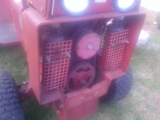

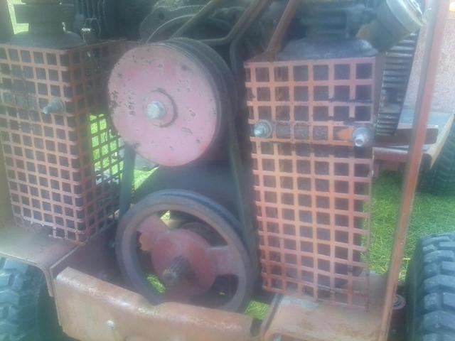

ok took some pictures
post-8758-0-57258700-1350760816_thumb.jp
post-8758-0-81817000-1350760822_thumb.jp
post-8758-0-11114400-1350760829_thumb.jp
post-8758-0-73654800-1350760834_thumb.jp
1maidenfan
Every thing looks correct :eusa-think:
Lets try engageing the pto (engine off) and try turning the pto shaft or pulley by hand. Like said before it could just be a loose belt, although from the pix it doesnt look that way.
Back on the sliding collar , there is a drift pin that holds it on the shaft although I believe it is splined on the shaft.
Quit possible that the pulley is stripped as it is splined onto the shaft also.
Keep us informed.

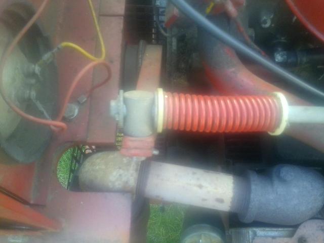

that adjustment rod on the PTO seems to be loose
I tightened it up but now it is barely onto the threds , it is at its max can not be pushed any further
I got it to spin the PTO agian with sparks between the plates. . . .
should I go try to till again?
1maidenfan

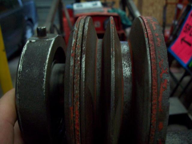

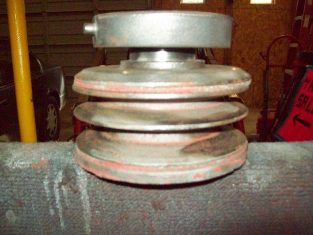

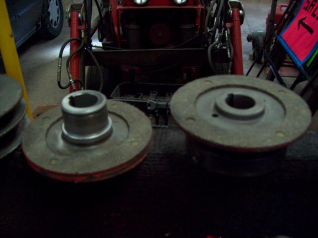

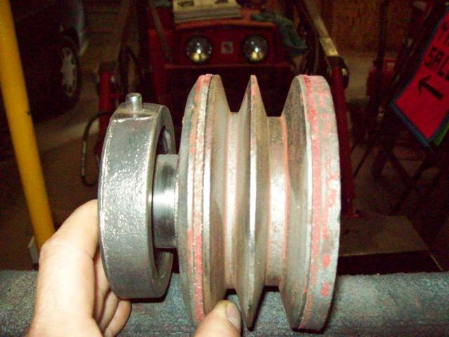

I would say NO ! Sounds like the clutch disk material is gone, there should NOT be any sparks!!! Need to look at the pto itself to see if the material is missing. Here are some pix of what to look for.
post-4490-0-16893100-1350762672_thumb.jp
You are looking for a thin layer of material between the outsides of the double pulley.
post-4490-0-77827100-1350762800_thumb.jp
post-4490-0-20483200-1350762816_thumb.jp
post-4490-0-02996300-1350762835_thumb.jp
blackdogfarm
yeah I dont think there is any material...... can I get new material? or do I need a whole new clutch pully system?
THe adjustment rod is adjusted to its max to get the PTO to engage.
If there are new plates between the pullys then the adjustment would be more on the other end right.
1maidenfan
Correct with the added material it will. Yes you can replace the material and there are some post on here about how to do that. I would NOT use it till you get it replaced, the material is cheap compaired to the whole clutch assy.

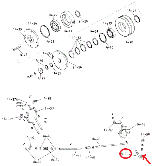

ok here is the diagram I think.... WHat part is it?
post-8758-0-81808800-1350768449_thumb.gi
1maidenfan
Its called a PTO clutch.
I searched ebay and at this time none available.
Post here in the "wanted" section make sure you say its for a D series.
blackdogfarm
14-24 or 14-25 or 14-33 or 14-34
1maidenfan
On this diagram it is part #'s 14-25 and 14-33 I believe. This is the material only P #.

i dont know where you are located but we have a place in south bend in. called south bend clutch that will reface that for you. o On the differences on a d 180 and an 18 auto the auto had either 15 or 16 in tires on the rear as opposed to the 180's 12s also the 18 auto i had ,had a shorter grill housing and the grill had 6 bars as the rest have 7
otrelwood
i guess this should have been my first post. Welcome to red square, good looking tractor and nice looking lab!!
