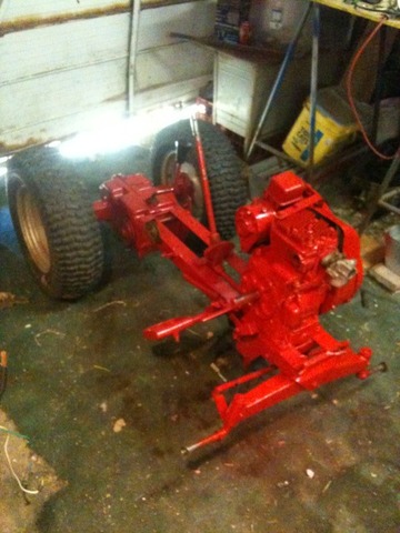

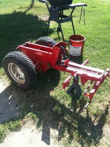

Basically this is what I started on a few months ago.
All I had done to it was bolt the fender and dash tower on, assemble the front axle and throw the rear tires on. Frame and trans were already together. <br />Then I stuck the 181 on it, but it was orange

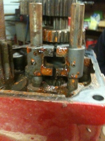

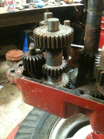

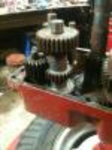

Oh BTW, for those of you who think a bit of surface rust on gears is Ok… one of the things about wheel horse transaxles I have noticed is they have a very smooth, tight mesh to them. That little bit of " surface rust on a couple of gears had that trans locked!!

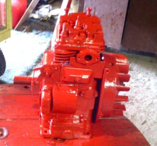

After a couple of months of walking by the orange engine sitting on my pretty, fresh red paint, and with the urging of my roomie who kept saying " you can't go to your first tractor show with nasty, ugly orange engine !"
So I ripped it off of there , and handed her some rags, cleaner and a can of paint. :)
Rooster
Before anyone says anything… this is her first time doing anything like this, guess I should have told her on engines there are some places that don't get painted
Rofl never thought Id have that lil tube on a can of carb cleaner stuck up in the engine cleaning paint off of the intake valve
It looks 10 times better than the orange!!

So with only three weeks to go for the Fly Wheelers show, I figured I better get that shiny piece bolted back on after dinner last night. So I grabbed the frame to roll it in the garage. Made it all of 6 feet when the rear tires locked up. :omg:
After a little inspection I decided to just drag it into the garage and would have to tear into the tranny.
Note: if you find your self dragging an 856 by the front axle with the rear tires sliding, if they decide to start rolling again right as you get to the gate of your back yard… you could end up with the impression of a cast axle in your thigh and gate latch in your back…just saying.
Rooster

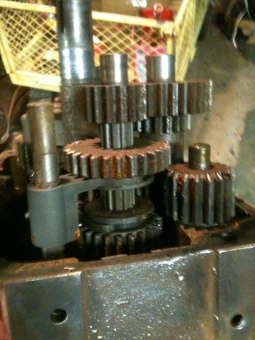

post-5219-134971151246_thumb.jpgpost-5219-134971153841_thumb.jpgpost-5219-134971157085_thumb.jpg
All of this led to 6 hours of polishing gears, a few new bearings and had to make a new gasket. Luckily the bearings that needed replaced I just happen to have in the garage. The lazy bearing store owners around here are close at midnight, on a Sunday?!?!

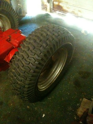

Anyone ever seen these? They are carlisles. 22x 7.50 Never seen any quite like them. They were with all the stuff I bought, holding air and in great shape so they are getting put to use! Not the tires I'd go buy, but for the price I think the little guys will look great on the little tractor ;)

22 x 7.5's is what my 1985, 310 came with.
Rooster
The wheels are silver? So I figured they came off of something in that era, maybe?
Jake Kuhn
My b80 has that size tire, we also got a set of nos tires that size and white rims in the lot we found.

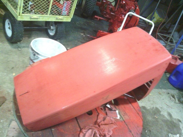

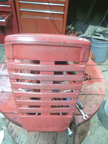

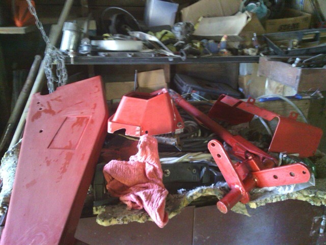

Here is one to make you jealous....
I'm at work, working late all week... :tools-hammerdrill:
SHE is in my garage sanding dash, fuel tank support, lift lever, belt guard, hood and fenders.....
:banana-tux::teasing-neener::royalty-crown: :music-rockon:

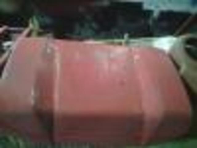

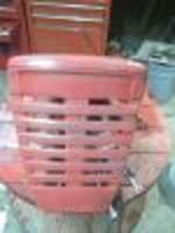

Well she just sent me pics of her work..

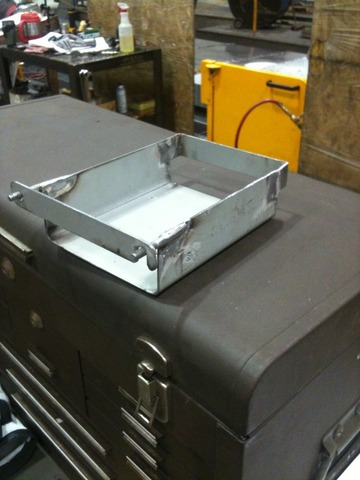

And while I was waiting on someone, I built a new battery box

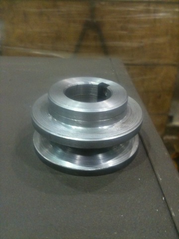

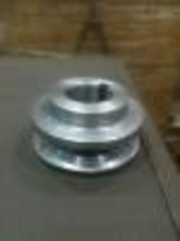

So I thought I had an engine pulley.
But when I was getting ready to put it on I noticed it did not have a key way in it?? post-5219-134993158905_thumb.jpg
So last week I made a new one.
Does anyone have any idea what this other pulley is?
It is a triple groove , 2" pulley with no key way.

Scrumpy
Rooster,
Pulleys can be ordered that way. Then the keyway and setscrews can be added in the size that is needed. I used to get all my woodworking parts that way from Boston Gear. Gears and pulleys would only have the center marked and you would send it to your local machine shop to be drilled and broached as needed. Likely this one was not finished.
Rooster
Problem is this pulley is so long that I'd need a production broach to key way it, and the broach cost about 20 times what the pulley is worth, lol!
Ohh...I am my local machine shop!
Also, the pulley is used....it was on something!
