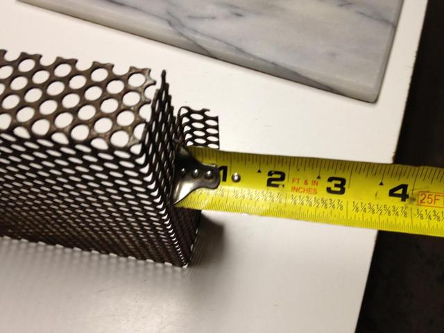

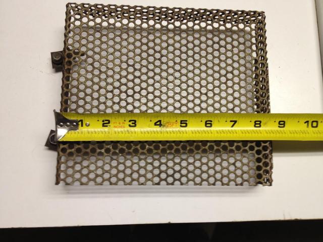

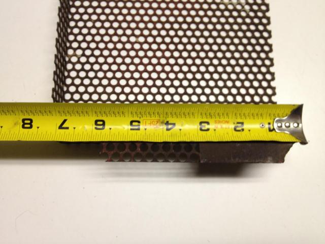

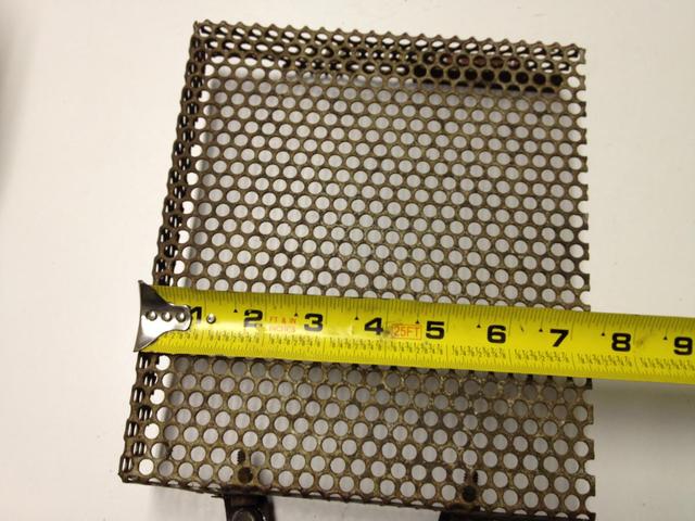

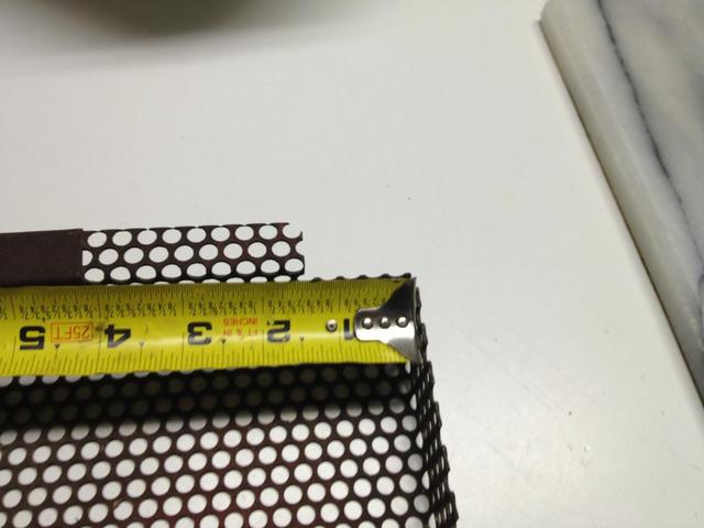

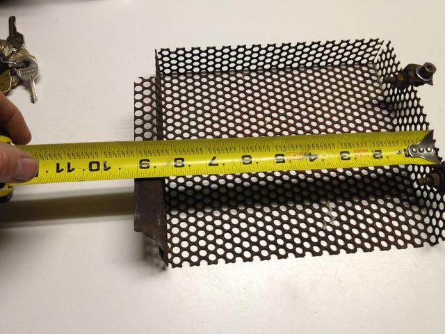

Martin

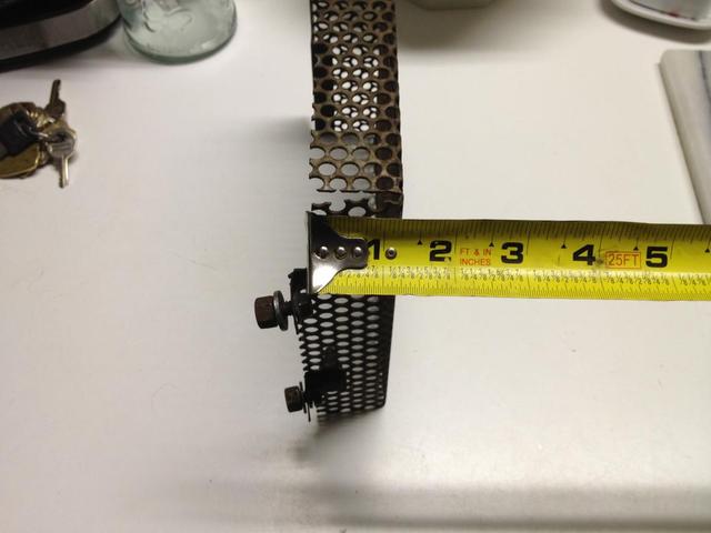

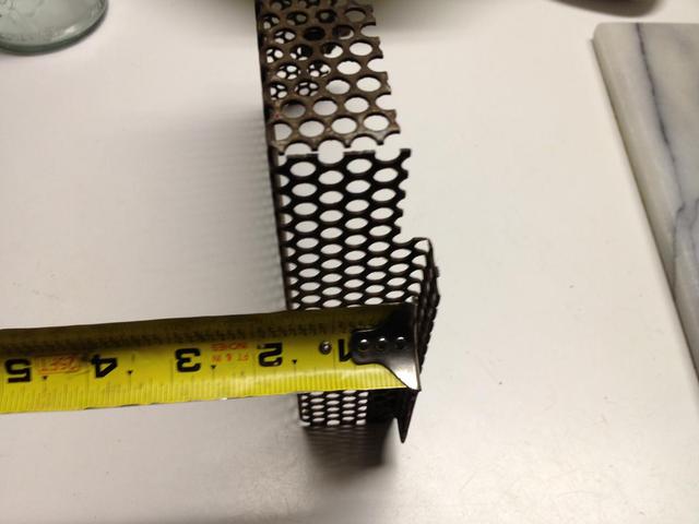

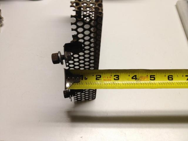

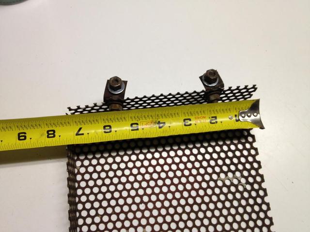

slick, been hectic here, ran out to the shop this morning and grabbed a few measurements for you. i hope you can make sense of my rushed pics.....
some of the camera angles are off, so i put the measurements above the pic.
if you need any more clarification just ask.
8 1/2"
post-4321-0-94322400-1350379685_thumb.jp
7 3/8"
post-4321-0-95369400-1350379702_thumb.jp
1 3/4" ( bolt tabs stick out a little more than the screen- the screen itself is 1 5/8")
post-4321-0-98709800-1350379731_thumb.jp
1 1/4"
post-4321-0-43721500-1350379747_thumb.jp
1 5/8" inside, 1 3/4 overall
post-4321-0-32475700-1350379760_thumb.jp

8 3/8" inside, 9 1/8" outside
post-4321-0-13302700-1350379806_thumb.jp

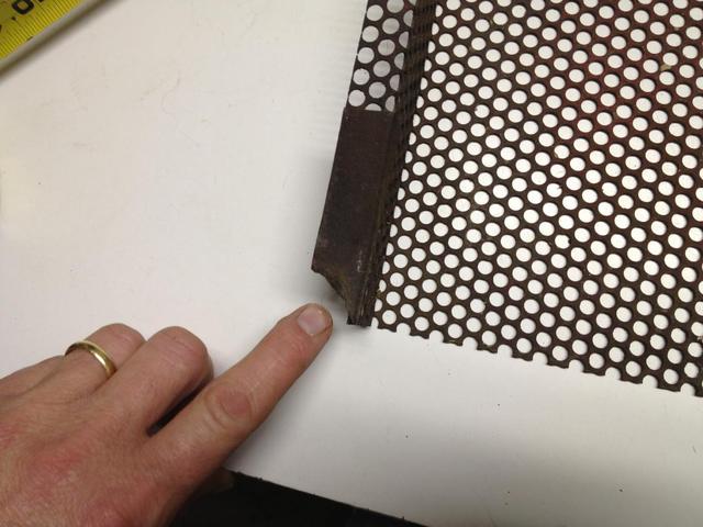

Martin
this corner is broken off, i think there should be a bolt hole here to fasten to the belt guard, mine had a larger tab bolted to the belt guard that the broken end wedged into. hole/bolt should already be in the belt guard
post-4321-0-26586600-1350379993_thumb.jp
bolt centers are roughly 1 3/4" and 5 3/8" this will be determined by the holes in the seat tool box..
