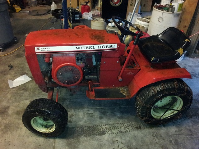

AmalgamousProxy 2 #1 Posted September 30, 2012 I just got a C-101 found in a garage in PA that has been sitting for 19+ years. Heck, I think it still has the original tires on it. When I got it home I went to cleaning and working on it in my spare time, the 10HP Kohler runs perfect. The smell of old varnished up gas is still lingering in my shop. However, I need some information please. I have been searching for what bearings part numbers and what not are needed to rebuild the PTO. The clutch is good, just the outer bearing is shot. I went to my local lawn and garden center and they pulled out their books and stood there scouring them and scratching their heads like a monkey looking at math problems for 30 min before telling me to check the internet. So here I am. 1 Share this post Link to post Share on other sites
MalMac 1,332 #2 Posted September 30, 2012 If your looking for just the outer PTO bearing, the part # is 109842. The part is available from a Toro dealer. I don't know what the actual bearing number is. That is just the number Toro uses. Press the bearing out and look for numbers on the bearing and you should be able to go to NAPA or any bearing shop and get it for a lot less than Toro will charge. Someone else may chime in here that knows what the actual number is. It is a common bearing to replace. 2 Share this post Link to post Share on other sites
AmalgamousProxy 2 #3 Posted September 30, 2012 Thanks! That was very useful, I was able to trace that number to a web site that sold tractor parts and came up with this: http://www.partstree.com/parts/?lc=toro_consumer&mn=81-10K801%2C+C-101+8-Speed+Tractor%2C+1978&dn=810006R2-06R20055-00027 Share this post Link to post Share on other sites
rmaynard 15,805 #4 Posted September 30, 2012 (edited) The outer bearing 109842 is very common. You should only have to pay about $3 or $4 for it. The inner needle bearing 106796 is noted as no longer available from Toro, but I bought 3 of them on eBay last year for $15.00 each. I will try to find the generic number for you later this morning. I just retrieved a bearing from the shed and it is an INA bearing, part number SCE 2420. Edited September 30, 2012 by rmaynard 1 Share this post Link to post Share on other sites

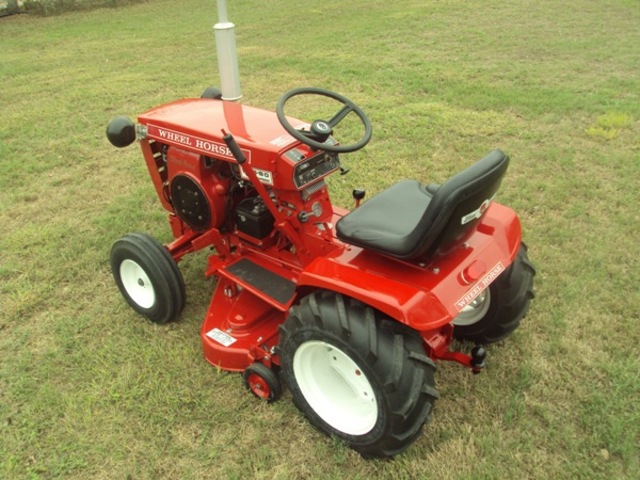

Ken B 3,165 #14 Posted October 1, 2012 She is your tractor and it is up to you to decide how you want to use it. I think maybe it is the much earlier tractors that once restored might see limited heavy work use. Parts are a little harder to find for the earlier models. Your C-101 is a pretty rugged tractor and parts are still plentiful for it and at reasonable prices. Personally speaking, when I do a restoration on a later tractor (1965 and up) I do what I call a worker restoration. By that I do mean totally gone thru and looking nice, but not over the top. This way I can still use it for yard chores without having a fit if I scratch it or ding it up. I have gone the show tractor restoration route in the past and all I wound up with were a bunch of tractors collecting dust in my garage because I didn't want to dirty or scratch them up. A worker restoration will take me about a month or so to do. A show restoration I have spent upwards of a yr. doing. This is an example of a worker restoration that I used pretty hard! Here is a video of a worker restore in action. 1 Share this post Link to post Share on other sites
AmalgamousProxy 2 #15 Posted October 1, 2012 I noticed a lot of ribbed V pattern AG tires on wheel horses across the sites. Do you guys do this for looks or for function? I know they provide superior traction but they are also known to mark up the yard quite a bit when making sharp turns. Heck I've seen images of wheel horses with dualies on the rear. Amazingly enough the tires on mine are in phenomenal shape for their age, although it's almost certainly superficial and are bound to need a new set sooner or later. Just getting you guy's opinions. Share this post Link to post Share on other sites
bowtiebutler956 650 #16 Posted October 1, 2012 Ag's work best for maximum traction, when pulling somthing heavy or working in the garden. Now if all your doing with your is mowing, then I would stick with a turf tire. I love the looks as well. Matt :flags-texas: 1 Share this post Link to post Share on other sites

kpinnc 13,122 #20 Posted October 2, 2012 I noticed a lot of ribbed V pattern AG tires on wheel horses across the sites. Do you guys do this for looks or for function? I know they provide superior traction but they are also known to mark up the yard quite a bit when making sharp turns. Heck I've seen images of wheel horses with dualies on the rear. Amazingly enough the tires on mine are in phenomenal shape for their age, although it's almost certainly superficial and are bound to need a new set sooner or later. Just getting you guy's opinions. Make no mistake, ag tires are used for both looks AND function. But as you said, they are hard on soft turf. If you plan to use the tractor for gardening (moldboard plow, cultivators, disc sets, or dozer blades to push dirt), they are very well worth it- as are tri-ribs up front. If you're just mowing or using the machine for "yard duties", they are not needed at all. A good agressive-tread turf tire will meet most any requirement without tearing up the grass, and they look good too. Nice 101 by the way. You probably own the only one that far east! Glad to see another NC collector! 1 Share this post Link to post Share on other sites
