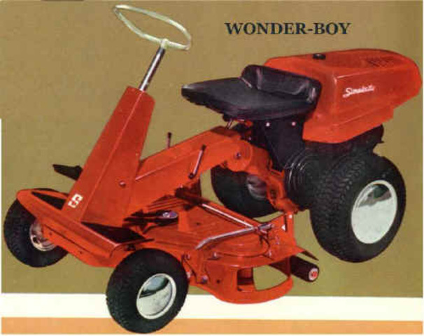

The Toolman 22 #17 Posted October 14, 2012 Yep, thats the one I'll probably buy tomorrow. Not the one I wanted, but this will do for the time been until I find the 9 hp monkey wards squire like I had. This is a Gilson made tractor from 1976. When I was young an my brother bought the new 9hp simp from Wards, I tried to get my Dad to buy the cheaper/ smaller vert shaft one, like the one above on the trailer, but I got stuck with a new monkey wards simp rear engine "Wonder Boy" UGLY but it did do a heckuva good mowing job. Ron Share this post Link to post Share on other sites

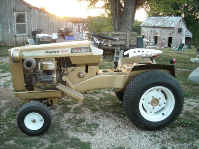

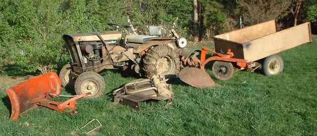

perry 82 #20 Posted October 15, 2012 i picked up two wards squire 9 tractors last year. sold one and kept one . here is mine sold this one last year. the guy just got finished with the restore. did a nice job on it . factory dual lifts carry-all Share this post Link to post Share on other sites

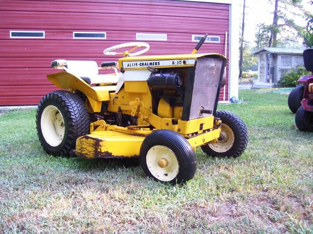

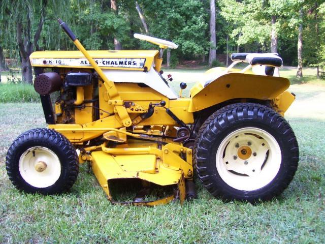

jay in nc 210 #21 Posted October 16, 2012 boy they sure are a big family, A-C- b-10 , squire, simplicity, wards, Any more? heres my b10 that i used to plow snow on when i was a teenager. had to go to tidiute pa to get it. boy they sure are a big family, A-C- b-10 , squire, simplicity, wards, Any more? heres my b10 that i used to plow snow on when i was a teenager. had to go to tidiute pa to get it. Share this post Link to post Share on other sites
perry 82 #22 Posted October 16, 2012 nice B-10 . they did homelite and JC-penny tractors too Share this post Link to post Share on other sites
