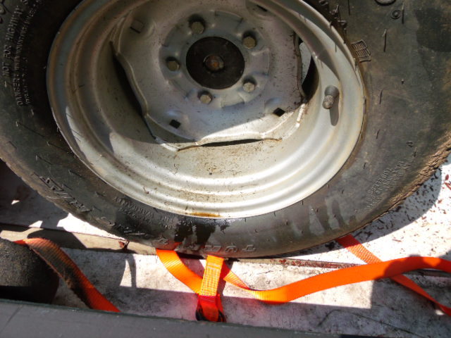

Torino 14 #1 Posted September 21, 2012 1999 520xi. It is leaking where circled. Could I be lucky and it is just a seal? How do I diagnose that it is the seal or something else? If it is a seal does anyone know the NAPA part no.? Share this post Link to post Share on other sites
rmaynard 15,780 #2 Posted September 21, 2012 Once the hub has been removed, the seal is easily replaced. You can get them from Toro or aftermarket from places such as NAPA. Toro # 6449 NAPA # NOS11124 After you have removed the tire and rim, there should be no movement of the axle up and down. In and out movement of up to 1/8" is okay. Up and down indicates a worn bearing which would require disassembly of the transaxle. Share this post Link to post Share on other sites
Kelly 1,030 #3 Posted September 21, 2012 It could be the machining was off when the trans was built, but most not all of the hubs I've seen semi line up with the trans case, in this picture it appears to be the hub is way high to the case, jack up the tractor and watch the axle/hub see if it drops? that might be where the dealer came up with the high $$$ to repair it. Share this post Link to post Share on other sites
Save Old Iron 1,568 #4 Posted September 21, 2012 if the bearing fails, the axle will drop and the top of the seal will most likely loose contact with the axle. Share this post Link to post Share on other sites
Torino 14 #5 Posted September 21, 2012 There is up and down movement on that side. What are my options? Share this post Link to post Share on other sites
