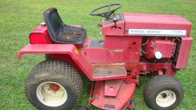

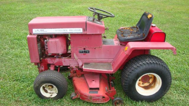

Howdie, I wanted to send some photos of my D-160 . I would love to find others that live in NC to compare notes. I am in the Mtns near Boone NC. I can't get this D-160 to run w/o the choke at half? The tank was cleaned, new filter, and the fuel pump is working. Any suggestions? I will attempt to add some photos. JA

did you clean the carb out

if you remove the plug on the bottom left there is a jet there you need to make sure its clear

Ok, i'll try that over the weekend. I just created an albumn- i think. I got these three D's from my Dad just before he fell very ill. He loved using the 180 for snow removal since it was new. I plan to restore it soon. This D-160 was sitting for 15 plus years. The engine was stuck when i started playing with it. I'm pleased to have it running at all. It mows very nice but i have to feather the choke. Thanks for the advice. I'm new to this. JA

Hop on 421 south and you will be here in a few hours. I got a D 160 with a finaky carb and a D200 witha problem hydro. The 160 came first and it was a PITA to get the carb close to working. Had major problems with it. I got a rebuild kit from garys place (google it) and the top and bottom halves had warped. i had to surface them to get it to sealup and not suck in extra air. Also had to reseal theintake manifold.
You can check for suction leaks in the manifold by running the engine and squirting starter fluid around the seam of the manifold to see if the engine changes sounds.
Running with the chokeon either means you arent getting enough gas through the carb or you are sucking air in somewhere.

I have a 1977 D-160 with the ONAN BF-MS engine that needed choke to run. I took the carburetor off and took it apart and soaked it overnight in carburetor cleaner. I installed a new float needle and seat that came in a kit. I reset the main jet and idle jet screws according to the service manual.
After I re-installed the carburetor with new carburetor and intake manifold gaskets, the engine lights right off and runs like a top with no choke needed except on cold start. The service manual provides all the details on how to do it.
