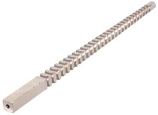

KC9KAS 4,741 #1 Posted August 4, 2012 Been working on a "new" plow for my GT-14. Information says it will handle a 54" front plow. I had a couple of fair looking 42" plows, so I took the best parts from both plows and made a nice 54" plow by adding 6" of plow to each side of the best 42". Now I am working on the plow cutting/wear edge. I wanted the 3/8" square holes for the 3/8" carrage bolts, but wasn't sure where I could get this done. At my work place they have a "mega-buck" iron worker that will do all kinds of stuff, but they don't have a 3/8" square die...Next best thing is a square broach. I have attached some pictures of the broach, plow wear edge, and the press I used to cut the 3/8" round hles to 3/8" square holes! This broach is round on the starting end, and is tapered to the opposite end, and is square. Up use a press to "push" it through the steel. 2 Share this post Link to post Share on other sites

can whlvr 993 #3 Posted August 7, 2012 lots of square holes are simply punched with a die and hydrolic pressure Share this post Link to post Share on other sites
AMC RULES 37,102 #4 Posted August 7, 2012 Looks like it works pretty good...hard to push it through? 1 Share this post Link to post Share on other sites
KC9KAS 4,741 #5 Posted August 8, 2012 No it was not hard to push through the steel. You start with a round 25/64" round hole (1/64 larger than 3/8") and the broach is probably 8" long. In those 8" you go from a 3/8" round hole to a 3/8" square hole. It is designed to be used with an arbor press (hand operated press), but a hydraulic press works fine too! 1 Share this post Link to post Share on other sites
rwilson 128 #6 Posted September 3, 2012 sure beats a square file!! Share this post Link to post Share on other sites
Tankman 3,516 #7 Posted February 7, 2013 sure beats a square file!! Looks like a square rasp! I've used many square punches when in the steel business, never saw one of these. Going to have to get one! :-) Share this post Link to post Share on other sites
