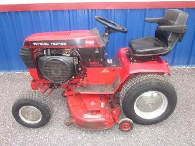

rmaynard 15,416 #1 Posted August 2, 2012 I have found a nice 1990 520-H at a lawn & garden dealer. He is asking $1500.00 for the tractor with a 48" deck, and a single-stage snow blower. Even though the tractor has close to 1500 hours on the meter, it has been regularly serviced. The engine sounds good, and the hydro is strong. Paint is in good shape, and tires are good. Here are my questions - should I consider it at this price? What else should I be looking for? The dealer will allow me to perform any tests or do any inspections that I want. Other than what I have learned here on RedSquare, I have absolutely no experience with anything bigger than my B-100's, and though I don't really need anything of this magnitude, I do need a new worker with a mower deck to pull my Cyclone Rake this fall. Any comments or suggestions are appreciated. Share this post Link to post Share on other sites
Sparky-(Admin) 21,300 #2 Posted August 2, 2012 Heres how I try to figure out the approximate value on the newer machines that have no collector value such as the 520. I try to put a dollar amount on the tractor and the included attachments to be sure I could liquidate it separately and get my money back. Then I offer less that the amount I come up with since I'm buying it as a package. So the deck/mule drive is a $350 item. The SS blower is a tough one to estimate since I don't know ifs its a tall chute of the same vintage or an older short chute. But a complete tall chute can bring $400 and the short chute around $250 in the winter. The tractor with no attachments and 1500 hours on the clock is a $600-$700 machine. That puts us at $1450 if its a tall chute blower. I would offer $1000 and let him come up to $1100-$1200. These are just my opinions on a tractor and attachments I have never seen so I hope I haven't insulted any 520 owners. Mike.......... Share this post Link to post Share on other sites

Forest Road 594 #7 Posted August 2, 2012 Is that photo of the actual tractor you're asking about? If so that's a 95 or newer. With all the bad press following the Onans over 1000 hours id offer $700 and no more. 1500 hours is probably bordering rebuilding that motor. That'll run another $1000. Good luck. Kevin Is that photo of the actual tractor you're asking about? If so that's a 95 or newer. With all the bad press following the Onans over 1000 hours id offer $700 and no more. 1500 hours is probably bordering rebuilding that motor. That'll run another $1000. Good luck. Kevin Share this post Link to post Share on other sites

rmaynard 15,416 #14 Posted August 3, 2012 Thanks for all the replies. I didn't have the time to take it for a test drive and do a real good inspection, but I do plan to do that next week. Kevin (Forest Road) - Yes, that is a picture of the actual machine. I don't know why I didn't look at the ID tag to be sure of what it was. Did any of the 520's have power steering? He did mention that this one did. Share this post Link to post Share on other sites
Forest Road 594 #15 Posted August 3, 2012 Bob Those decals and rubber running board covers were used on the later models starting in 95 or 96. That also has the gear reduction steering. It'll feel much easier to steer than a regular horse. Therefor it takes a bit longer to make a turn. Its a great feature if you're running either snowblower or an FEL takes all the effort out of steering. Go get it! Share this post Link to post Share on other sites
BOWTIE 226 #16 Posted August 4, 2012 HELLO, DIDN'T ALL THE 96 MODELS HAVE GOLD TINTED DECALS FOR THE 60th ANNIVERSARY. THOSE NICER FOOT PADS STARTED IN 1996, SO MY GUESS IS IT MUST BE 1997. ONLY A SERIAL NUMBER WILL TELL US FOR SURE. GOOD LUCK IN TRYING TO BUY IT. BOWTIE IN OHIO Share this post Link to post Share on other sites
CRE1992 135 #17 Posted August 4, 2012 My bet is it is a 1995. Share this post Link to post Share on other sites
MalMac 1,331 #18 Posted August 4, 2012 That tractor is a 94 or 95, the price is in the ball park if it did not have that many hours on it. With it being an Onan and not knowing how the motor was cared for is the drawback. Like said earlier if that motor takes a dump it will not be a cheap fix. I would approach this deal with the idea of there is not much life left in that motor. It will be very hard to convince the seller that the motor is on the down side of life when the tractor looks good and runs good. To me it's the pit falls of the Onan. Share this post Link to post Share on other sites

6wheeler 603 #21 Posted August 4, 2012 Bob. If that is a picture of the actual tractor, it looks just like my 91. Mine does have the gear reduction steering. The deck even looks like mine. Hard to tell from a pic though. I think the 520's with a 48" deck are the ultimate mowing machine (with the G.R. steering) The 20hp engine really spins the deck. So, even in taller grass I can move right along. That does seem like a lot of hours. But, if it was well maintained and didn't spend its years as an outside guest by the former owner. It should be ok. I don't know how these tractors sell out there, as far as prices are concerned. But up here, there was one that I had heard about with 1200 hours and a 48" deck and snow blower. It was a 91 and was well maintained strictly by the dealer that sold it with complete records. The owner was asking $1950.00. And when I called, it was gone. I asked if he got his price? He said "yep, I got 11 calls on it. The first guy that came to look at her loaded it up". I just happened (by accident) to come across mine. It was sitting in front of this small engine shop in town and when I stopped to look at it. The guy said "I just dragged it here, it ain't got no deck and it won't start". I had my trailer on with my C-120 on it coming home from mowing the Eagles club lawn. He said "what do you want for that"? I said, " its not really for sale but, what will you give me"? He says, "I'll trade ya even up". Done deal... I have a 520. I'm not too concerned with the Onans either. I had a 48' Henderson bulk feed trailer with a P220 running the hydraulic pump for the floor belt and the 45' auger. When I sold that trailer, the engine(original) had 5885 hours on it and ran great. But, the unit had a 30 gallon gas tank for a reason, them Onans are thirsty. Good maintenance will make anything last. I changed oil every 100 hours. It was a little finicky when it was -30 though but, so am I. $1500.00 seems a bit high. But if I could run it for say 10 years and not have a lot of trouble? Well, thats $150.00 a year. Seems like cheap power to me. That's my $3 dollars and 12 cents worth. Share this post Link to post Share on other sites
TheReDStAnG 4 #22 Posted August 5, 2012 Well its not a 97' as they used a different seat, steering wheel, and came with the plastic hubcaps. So my best guess would be 94' or 95'. Based on the pictures, I would be hard pressed to believe that it truly has 1500 true hours on it. Original tires, perfect seat, deck looks of same era and not been eaten through, no major body flaws, no mentioning of loose steering, broken gauges, etc. My guess is someone was bad at leaving the key partially on. (I learned that the hard way). If your looking for a keeper, then it sounds like a fair deal as long as everything checks out. If your looking to try it out for a year and possibly resell, you probably need to be at the $1,000 mark. I personally wouldn't go look at a tractor with 1500 hrs (working hours) on it especially with the Onan. (That's coming from someone with 3 of them). Share this post Link to post Share on other sites
Save Old Iron 1,566 #23 Posted August 5, 2012 I would be hard pressed to believe that it truly has 1500 true hours on it. . My guess is someone was bad at leaving the key partially on. (I learned that the hard way). A 520 hour meter will not accumulate hours without the oil pressure sensor "seeing" correct oil pressure. Unless the PO has modified the wiring, hours can not increase without running the engine. Share this post Link to post Share on other sites
