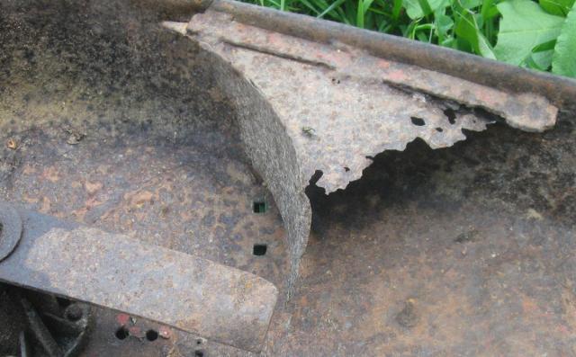

markjs 2 #1 Posted July 28, 2012 I got this deck recently- it came with a tractor I bought. It has some pretty serious rust underneath- it's badly pitted to the point of being eaten through in several areas. My question is can it be repaired, perhaps patched with new sheet metal? The spindles are very good and the topside is decent. I don't have much experience with sheet metal. Can someone give me some advice? Thanks. Share this post Link to post Share on other sites
JamesBe1 84 #2 Posted July 29, 2012 Sorry to say Mark, that looks pretty darn bad. I doubt that there is any chance of salvaging the baffle. My opinion would be to cut it out and replace it with new metal. You're going to either have to learn to weld a new piece in or have a friend do it for you. I went through something similar recently with one of my decks. Luckily a friend (Hodge71) came to the rescue and welded some torn baffles under my deck. I don't have much experience with sheet metal either, but as soon as I can afford it, I am going to pick up a welder and start making lots of mistakes ; ) Share this post Link to post Share on other sites
markjs 2 #3 Posted July 29, 2012 Lol I hear that about the mistakes. I don't have a welder but I can stick weld half decent on thicker material- I've just never done any sheet metal. And I'm not so concerned about the baffles- I think I could live without those but the shell of the deck itself is eaten through in several spots; that's just the pic I had handy. Sooo... Share this post Link to post Share on other sites

D Block 2 #12 Posted August 3, 2012 I just picked up my 310-8 a few weeks back. I pulled the deck to remove/sharpen the blades and give the underside a spray down. I noticed rust on the front upper part of the deck. Near where the front right mount is. I hit to with the grinder and before I knew it there was nothing left. I grabbed a piece of 1/8" stock I had kicking around and cut/formed a patch from the inside. A few tack welds later and a couple holes for the mount and I was back in business. It's tough to burn thru these decks, they're pretty beefy. As long as you're not concerned with looks, buy a welder and get cracking! Share this post Link to post Share on other sites
welderman85 53 #13 Posted August 5, 2012 i bought a c-85 with the 36" rear discharge deck (i think 36" is right) it was a rusted mess but i hate to see red metal go to scrap. i bought some 10 gauge steel and started welding i cut out and patched it like a you do body work. it worked great all you need is a way to clean the rust off. some steel and a welder you can make it last for ever. depending on how big the holes are you could clean it the best you can then paint with good anti-rust paint.the deck on my 314 has had a few holes for years i just tryed to fix it so it didnt get any worse untill you can do it right. Share this post Link to post Share on other sites
