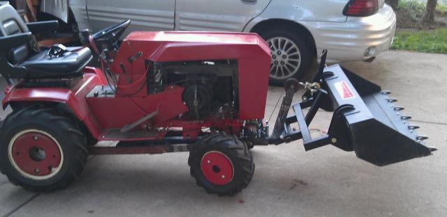

B-8074 19 #1 Posted July 14, 2012 Whipped this up the other day. I haven't finished my front loader yet and need to move 7 tons of sand for my dad and 10 tons of limestone for my friends park I take care of. I think it should do the job. Anything is better than a wheelbarrow. 1 Share this post Link to post Share on other sites

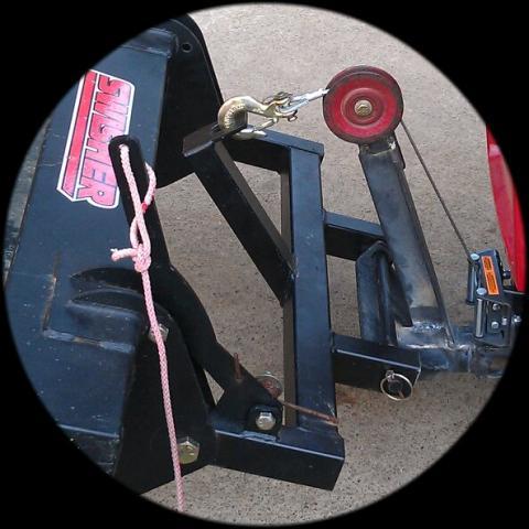

B-8074 19 #4 Posted July 14, 2012 Thanks, I didn't like the winch mounted up front so I moved it. It would smack the front tach matic when the scoop sprang up. Share this post Link to post Share on other sites

B-8074 19 #14 Posted July 15, 2012 Yeah boy, that's bad a$$. I wish we could see it in action. I'll get some video for ya when I get up to my dads this week. It works better than I thought it would. We needed to level to spot for the pool some more and I was able to dig out 6" of dirt. Share this post Link to post Share on other sites

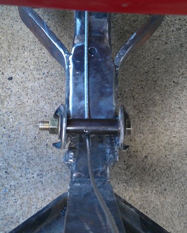

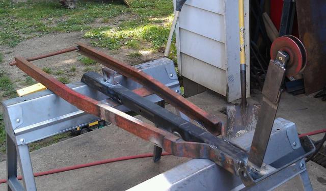

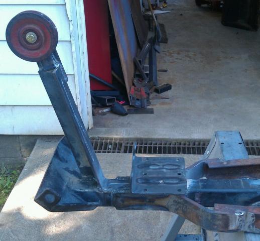

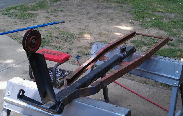

B-8074 19 #20 Posted July 17, 2012 Fantastic work! Could you post more pictures of the bucket release? And anything else that might be of use to use who might build one. What gauge steel is the bucket madew of? Thanks Thanks for all the compliments guys. Here are some more pics. If anyone wants a close up of something let me know and I'll get it for you. Share this post Link to post Share on other sites

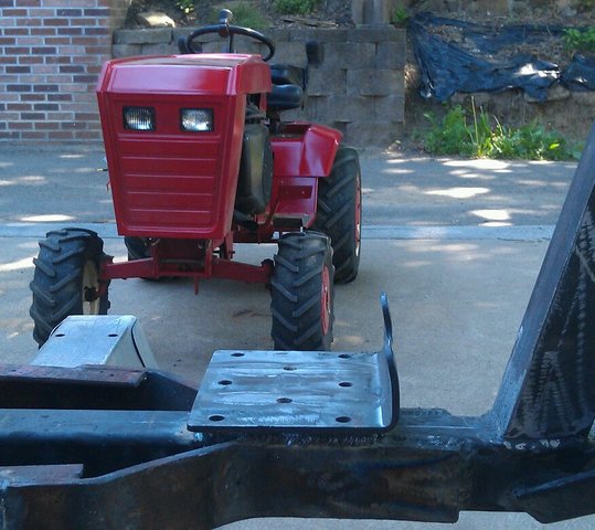

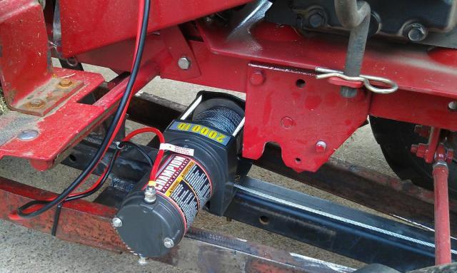

B-8074 19 #21 Posted July 17, 2012 I had the winch mounted up front but it put a lot of stress on it so I moved it back by the mid tach- matic. You can see how the mounting plate bent under the stress. I added a make shift roller from an old jeep shackle and bushing. Share this post Link to post Share on other sites
