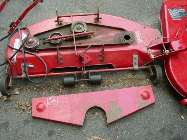

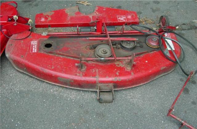

Had a problem with my computer freezing up last night trying to edit pictures. Try again today. This is a picture of what the fellow told me was a Wheel Horse111-6. When I tried to put the picture in yesterday it was to big and was downsized to the little picture. Also a front and rear picture of my deck. The broken spindle housing is what I am hoping would fit from the other tractor, or the complete spindles.

OK, after seeing the pics I'm sure you can use the RD deck off the B-111 if you were to install hanging hardware like your SD deck has off the C-100. Might have to drill it for mounting holes. The PTO drive belt that spins your SD is probably not going to work on the RD either Wrong length.

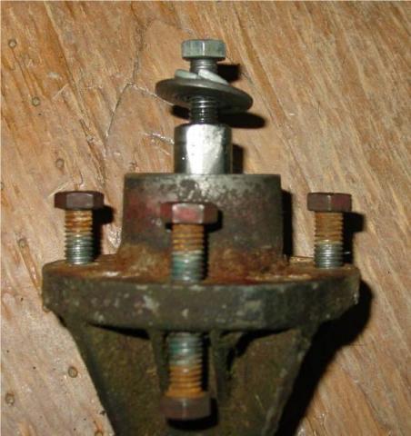

Make sure you look at the blades, the 48" deck in the pics with the missing spindle uses the old style blades double D with a bolt holding them on, the 42" RD deck I think you will find has the blades with the 3/4" hole and nut holding them on, the spindles will swap but blades and pulleys on top will be wrong.

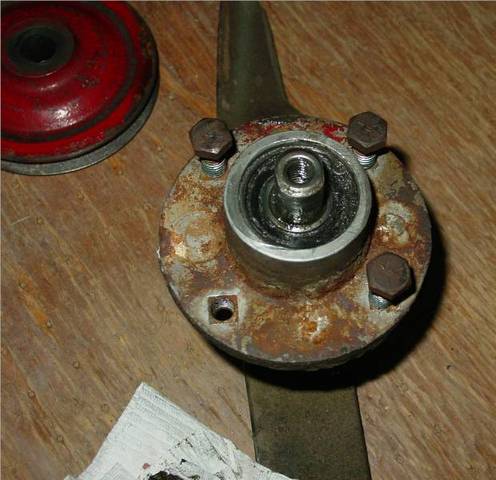

I found out they are not all created equal. I took a few more pictures of my spindles that show the difference that Kelly was talking about. My spindle is threaded on the inside on the top and the grease fitting is in the lower body section. Also blade is bolted on the bottom the same as the pulley on the top. The pulleys are also cast iron and a larger diameter. Still looking. Thanks, Pete
