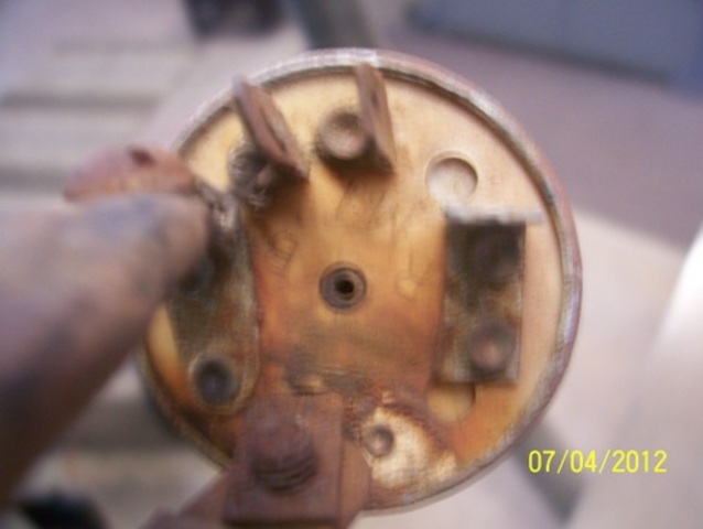

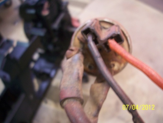

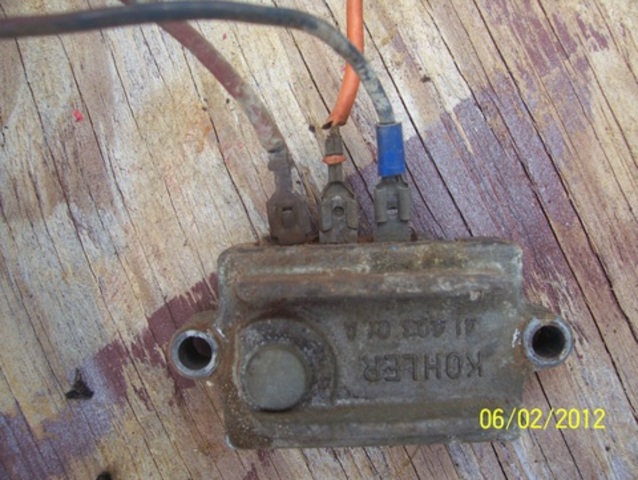

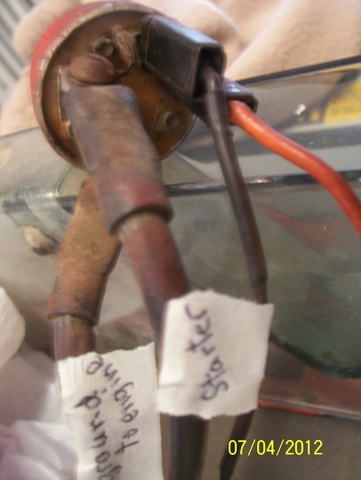

rockinhorse 45 #1 Posted July 5, 2012 I am building a w/h tractor that has a breakerless (no points) charging system. I know nothing about this and have managed to not label everything before i tore it apart. I did take some pics and labeled some wires . The starter switch has a loose post so i need to change . does anybody have a # for this switch? On the switch 1 big black wire goes the starter, 2nd wire goes to ground the motor , orange wire goes to center post on rectifier, little black wire comes from coil pack. Now some how i managed not to identify where the positive cable on battery goes and where the neg. cable on battery goes. If someone has a couple of pictures i could see it would help a lot . Is there anything special about this system that i need to know . Can i get the starter switch from NAPA? THANKS Karl Share this post Link to post Share on other sites

JC 1965 1,530 #4 Posted July 5, 2012 That looks like switch # 8362 if it is, the terminals are marked B (battery) M (magneto) S (starter) R (rectifier) L ( lights and other accessory). Large wire from B terminal goes to positive side of battery. Large wire from S terminal goes to starter. Wire from M terminal goes to coil. Wire from R terminal goes to center connector on rectifier. Wire from L terminal is for accessories lights etc. The negative battery cable goes to ground somewhere on tractor ( frame etc. ) I don't know if you can get this switch from NAPA but you can get it from Toro and Parts Tree. You might get a used one on E-bay. Hope this helps. :thumbs2: Share this post Link to post Share on other sites

KATO 115 #6 Posted July 5, 2012 That is the same switch as my 70 raider. it is available from Toro dealers ,about $48.00 U.S. Share this post Link to post Share on other sites
Trouty56 565 #7 Posted July 5, 2012 Well you could get a magneto switch at Napa and put a solenoid on it if all else fails. Maybe 35 bucks. sent via mobile.... Share this post Link to post Share on other sites
Save Old Iron 1,565 #8 Posted July 5, 2012 He talked like the switch has a solenoid in it . Karl, The ignition switch does not actually contain a solenoid but with heavier duty contacts than the average ignition switch, the 8362 will function AS A SOLENOID WOULD - passing the large starter current thru the switch body instead of having the ignition switch trigger a starter solenoid. I agree with Trouty - purchase a less expensive switch and use the remaining $$$ to but a starter solenoid and two extra starter cables. It a much more RELIABLE setup and will last far longer. Share this post Link to post Share on other sites

rockinhorse 45 #14 Posted July 6, 2012 save old iron in your pic you show only 1 wire to rectifier . On breakerless there were 3 wires to rectifier 2 came from behind flywheel i do not use these now? I will not use any wires from behind flywheel right ? The plug on block has to be knocked inwards right? Use a small punch ? I bought a new oil pan gasket today. The raider frame i have does not have a hole for amp gauge is gauge a good idea? I can get hole saw to cut out if it need one. You showed in your diagram a safety switch ? do you mean fuse block? THis is all new to me but i am excited to get started and see it work. Share this post Link to post Share on other sites
Trouty56 565 #15 Posted July 7, 2012 There should be 3 wires coming from the engine....2 of them still go to the rectifier (the AC wires) for charging but the other one that would have been the magneto wire is not used in the point setup. Share this post Link to post Share on other sites
Save Old Iron 1,565 #16 Posted July 7, 2012 Karl, all great questions - someone is paying attention!! Trouty is correct. The stator wires from the engine are connected to the AC terminals on the regulator/ rectifier. Orientation is not important - either stator wire can go to either AC terminal. The diagram I created makes some basic assumptions. One assumption is the reader understands the ground connections are not shown for various parts connected to the chassis or engine block. Starter, points, condenser and even the battery are all shown without ground wires or connections. These are all eliminated from the diagram to keep visual "clutter" to a minimum. The same is true for the AC connections to the regulator/ rectifier. Backing up a few steps, have you decided on the ignition system yet - points or magneto ? Your answer will determine which ignition switch you will need to purchase. As a reminder NEVER CONNECT THE MAGNETO WIRE TO A 12 VOLT POWER SOURCE - DOING SO WILL DESTROY THE MAGNETO COIL To address your other questions The plug on block has to be knocked inwards right? Use a small punch ? I bought a new oil pan gasket today Yes, the plug is similar to a thin steel freeze plug seen on automotive engine blocks. It will fall into the engine and into the oil pan. You have an oil pan gasket, remove the oil pan, clean it and retrieve the plug. While inside the engine, check for loose balance gears (search for the phrase balance gears to find previous posts relating to loose / wobbly gears). The raider frame i have does not have a hole for amp gauge is gauge a good idea? I can get hole saw to cut out if it need one My opinion is a gauge is only good if you know how to interpret its reading. I have run tractors for years without a gauge and never missed having one. Most tractors do not have a gas gauge and no one misses those. Folks who have amp gauges hear arguments stating a voltmeter is better. Folks who have volt meters rarely know how to interpret their readings! The folks who argue you should have both are on the right track. If you remember to perform a routine check of electrolyte level in the battery, save the price of a meter and put it toward your next battery purchase a few years from now. FYI - should you decide to pursue installing a gauge, a hole saw would be the way to go to drill out the dash tower or shifter panel. You showed in your diagram a safety switch ? do you mean fuse block? The safety switches in depicted in the diagram are generic representations of the neutral safety switches or PTO safety switches commonly found on newer tractors. They represent the real world switches or relays that would interrupt power to both the ignition system or the start system to protect the operator. The exact wiring for your switches - if indeed you tractor has /had them - will be particular to your model of tractor. We can cross that bridge when we get there. Let us know what model TRACTOR you are working on and we can advise you in more detail on what safety features would be present. As far as fuse blocks / holders are concerned, those are simple additions to any wiring. Again, let us know what model tractor you have and recommendations can be made. My diagram did not include fuses for the sake of visual clarity in showing just the major functions of the electrical system. I'll be happy to update additional diagrams to include these additional levels of detail. We also need to get you an operators manual for your particular model. A wiring schematic would be included in that documentation. THis is all new to me but i am excited to get started and see it work. I can say that we are excited to be able to help you out on your journey into a new hobby. Great questions - keep them coming. Share this post Link to post Share on other sites

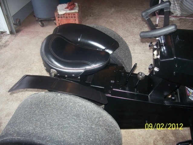

rockinhorse 45 #20 Posted September 28, 2012 Just want to thank everbody who helped me with my wiring project. The tractor is done for the most part need a few cosmetic things done . A big thank you to SAVE OLD IRON the tractor has a lot more spark now, INDY W/H ( marshall ) for the parts, MARTIN for the exhaust port help, and KELLY for the advise on the brakes. Here are some pics of the tractor again thanks for all your help. Karl 1 Share this post Link to post Share on other sites
Trouty56 565 #21 Posted September 28, 2012 Holy chitski!!!! Nice...I mean really nice!!!!! Share this post Link to post Share on other sites
Foozerush 40 #22 Posted September 28, 2012 Man does that thing scream ATTITUDE!!! Man hat's off to you.... one great looking tractor there... BRAVO!!!! Share this post Link to post Share on other sites
Save Old Iron 1,565 #23 Posted September 28, 2012 Very stealthy glad I could be of assistance :handgestures-thumbupright: Share this post Link to post Share on other sites
JC 1965 1,530 #24 Posted September 28, 2012 Wow !!!! That tractor looks great. Glad you Got it done. Are you glad you went with the points setup ? Any way it looks really good !! :thumbs2: Share this post Link to post Share on other sites
KATO 115 #25 Posted September 28, 2012 AWESOME !!!!!!!!!! Share this post Link to post Share on other sites
