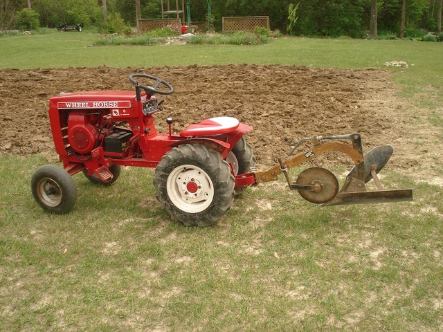

bean 85 #1 Posted June 23, 2012 I am thinking about doing an engine/transmission swap on my '73 8hp. I may put a 10hp magnum engine and 8spd trans into the 8hp chassis. the 310-8 tractor is a real nice design, but it just doesn't do anything for me. I really like the 8hp's size and looks. the 8hp kohler gets the job done, but when plowing or using the 42" deck, it is always at the edge of its power. the 10hp just walks through the same workload. I did several rough measurements and it looks like everything will bolt in. it will be a short frame, 10hp, 8spd tractor . if you haven't seen a commando 800 or '73 8hp in person, I can tell you that they are small tractors. I had a b-80 and it towered over the '73. I will say one thing, the kohler 8hp k181 is an amazing engine. if you take one apart, it is obvious that they were built to last forever. I just need MORE POWER. I know I am probably crazy for even thinking this, but my '73 is the tractor I like best. it is like an rj or lawn ranger, but with electric start, tach-a-matic, modern pto, etc. I am looking at a snow blower and tiller, and will need the 10hp to make it work. any opinions on this undertaking? 1 Share this post Link to post Share on other sites

bean 85 #10 Posted June 23, 2012 I did a little closer measurement and the 10 will probably not clear without modifying the hood. it is so close. there is probably 1/4 clearance in several spots. I'm afraid there may be some cooling issues. I think it can still be done.. when you get the 8hp and 10hp kohlers side by side, the size difference is quite a bit. the 10hp is a very large motor, by comparison a 12 hp 8spd would be fantastic.that could also be a possibilty. I see several 12hp's in my area craigslist Share this post Link to post Share on other sites

bean 85 #13 Posted June 24, 2012 Can you just change the sheet metal from one to the other? Are they the same wheelbase? no, the 310-8 is a long wheelbase tractor. the 8hp is a short wheelbase. there are a lot of other differences. the 8hp could be a spare tire for the 310-8. it's pretty small. there are some interchangable parts. the front axle is one. Share this post Link to post Share on other sites
