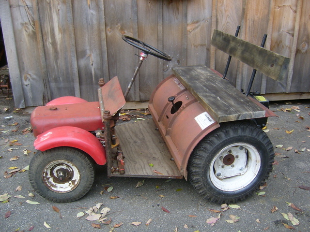

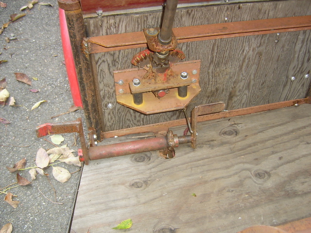

How have you managed to do the offset left hand drive stearing and how is the engine drive connected
Or is this top secret information.
I would love to have the time and inclination to be able to build one of those
this is what makes these wheel horse tractors so amazing with everything that just bolts together. like Meccanno

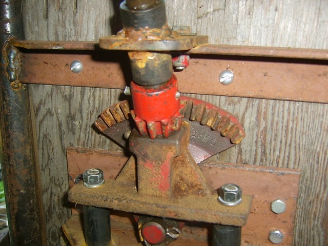

No top secret processes here, just made it up as I went along. If you magnify the 3rd pic, you can see the normal steering components mounted to a piece of angle steel. On the front side, I cut the shaft, made a bearing to support it and welded that on and a sprocket on the shaft. A #40 chain goes from that to the other piece of shaft with an added bearing and sprocket which is in the "normal" steering position. So far untested but it should work out OK.
The drive belt is routed around the axle and needs to be put on before the tires. I still need to work out the details for how the clutch and brake will work.

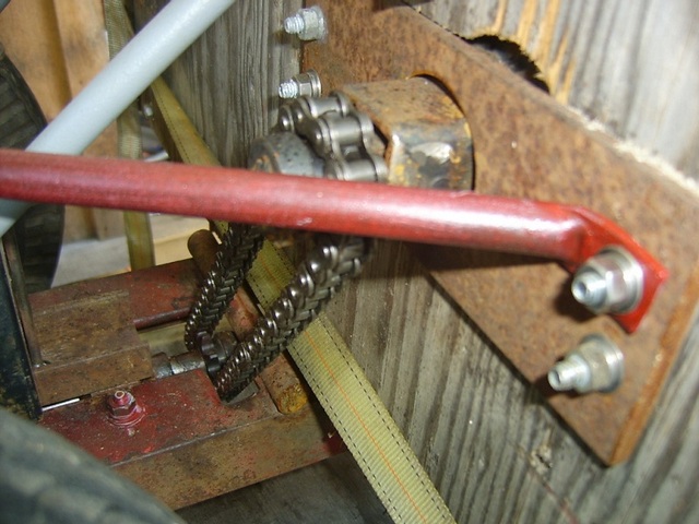

Here are some pics of the steering setup. There is a piece of steel tubing used for a bushing inside of the square piece and then the sproket was welded on

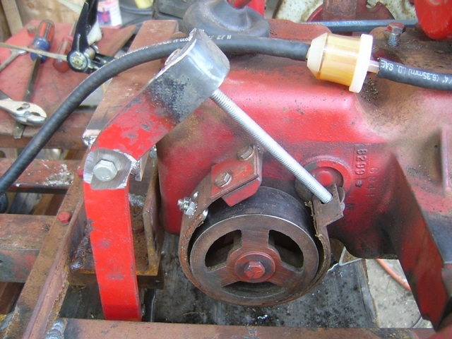

wallfish

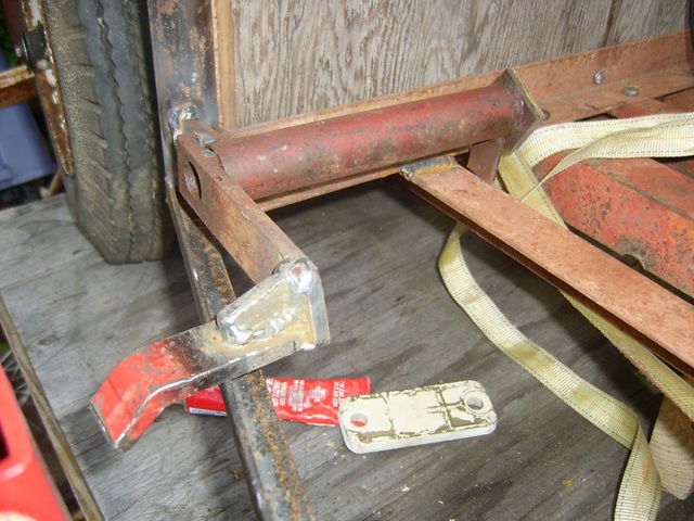

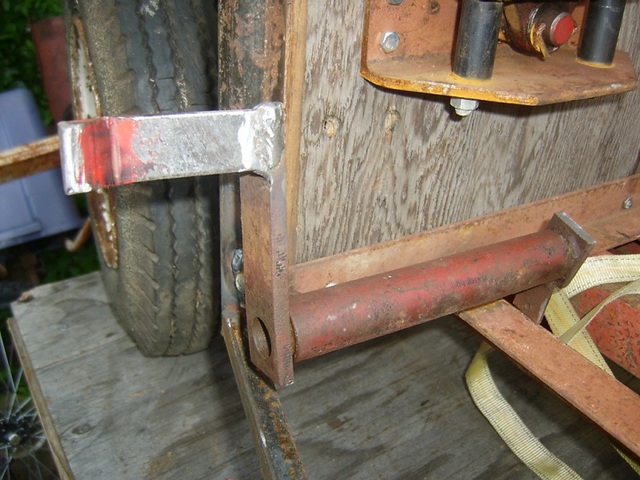

This is the new brake linkage and pedal. Pedal is made from the old snow plow index handle.

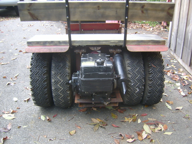

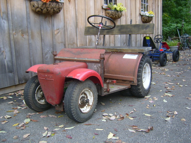

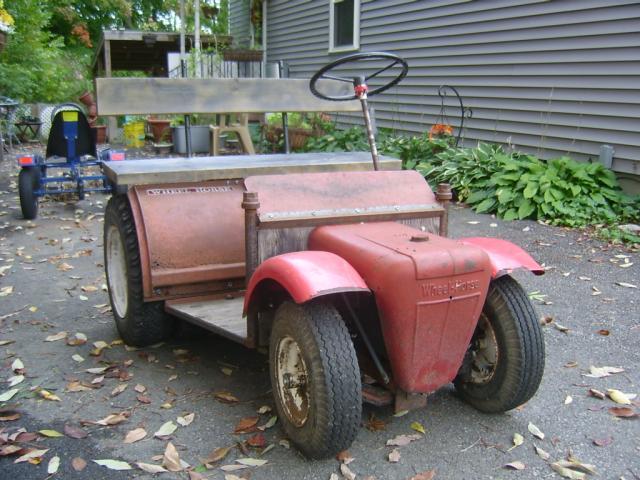

Finally made some progress on this. It runs and drives great so I'll bring it to the Zagray show next weekend. There are still quite a few things that need to done but most are just cosmetic. This isn't what I originally had in mind for the seat but it works for now and doesn't look too bad. It has a pull start Kohler M8 for now but will be upgraded to an electric start eventually. Here's some pics

At least it's on seat springs, It's actually not that bad of a ride although the motor seems to have a little more shake in it than it should.
